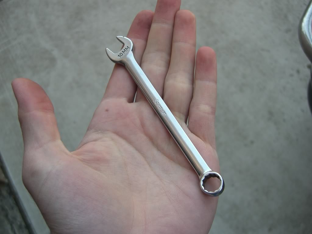

what you'll need:
-your vehicle (of course)
-a wrench (that fits the bolts on the hood latch, 10mm for mine)

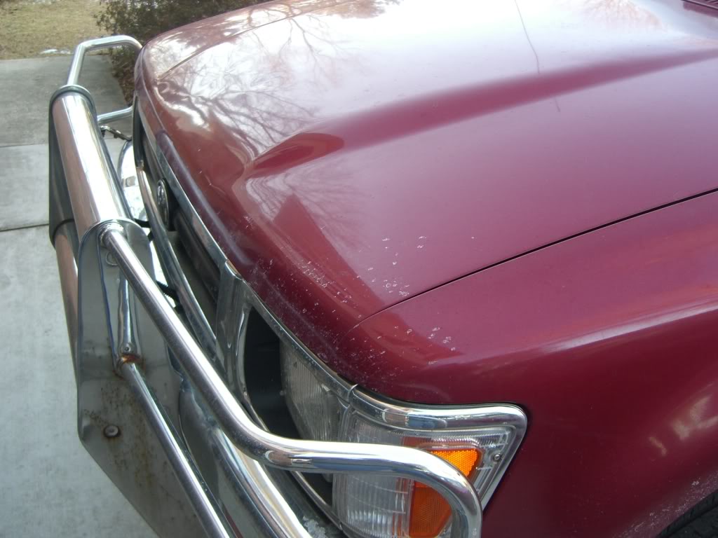

step 1-
does your hood look like this after you try closing it?
then this is your problem. the latch has been slid down after years of faithful service

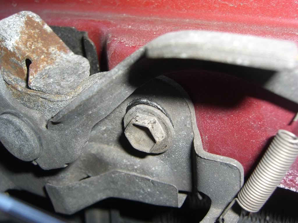

step 2-
loosen the bolts holding the latch on, but slightly snug
