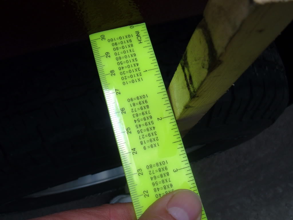

stupid stock tires (original 18 year old tires.....hahahahaha)
put my good ones back on, so i had to make the fender flares
yup, they stick out
stick out quite a bit .....too much for Pennsylvania standards

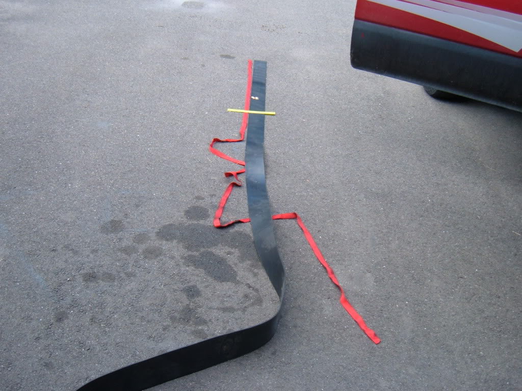

CONVEYOR BELT

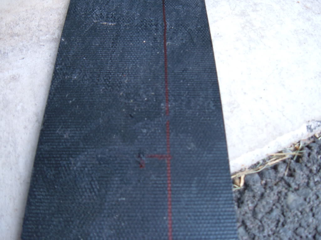

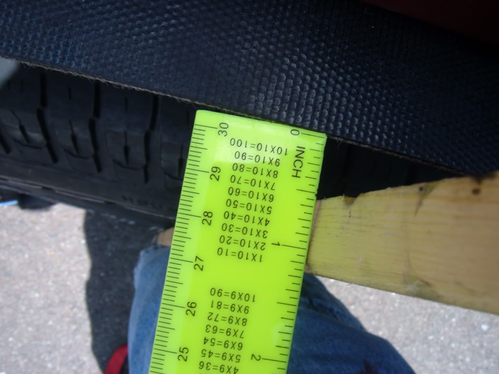

didn't want it to look real stupid, so i limited myself to one inch of coverage......enough to keep me legal though.
finished 1st one....

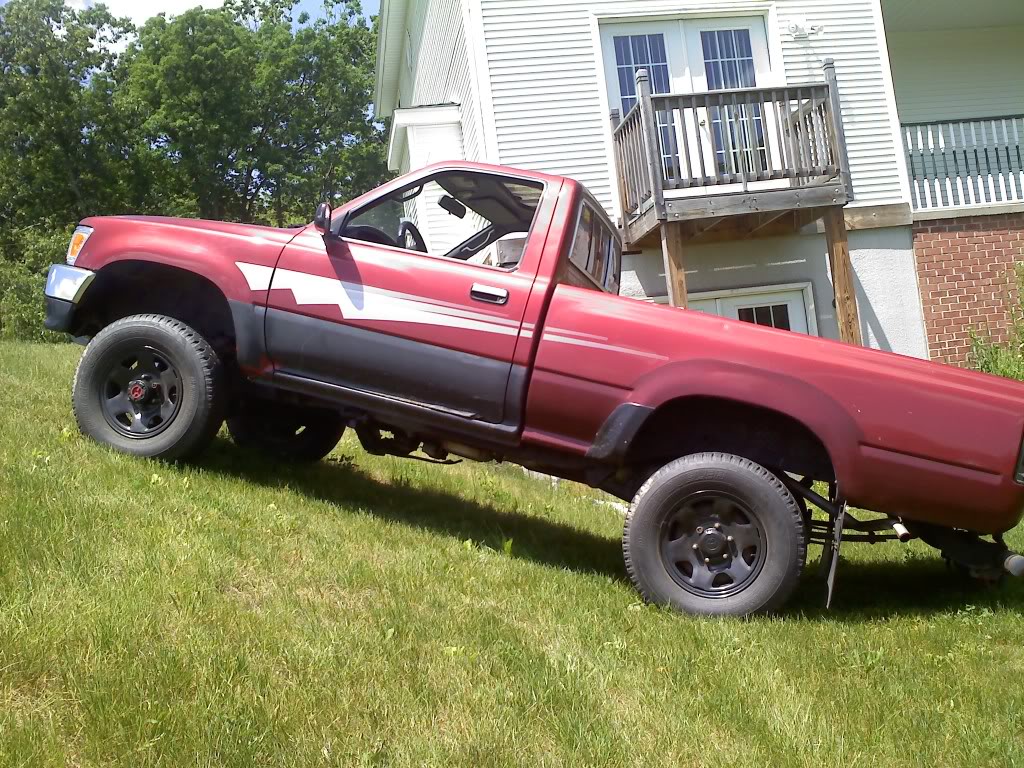

so....now i'm legal again
only thing i would have done differently, is drill the holes as i go along.....to allow for the material to conform to the curve rather than the way i initially did it drilling before i put them on, forcing it.....caused some gapping.
all in all...a very easy project, $48 spent to do it, probably will take about 20 minutes per wheel. but saving a citation is worth it.

ron....those tires make a guest appearance every now and then....and are in unbelievably good shape.....only a few thousand miles on them i assume....back in storage again now.
fender flares are holding up well......flexible enough to take a hit (they did alot this past weekend 4wheeling) and retain their shape. i still would like to tweek the installation a little so that there is no gapping.
