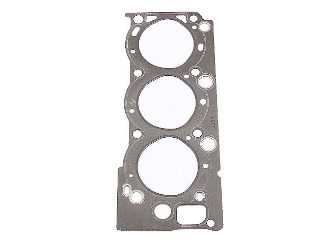

I should also add that I have no proof that the Ishino HGs for the 3VZ-E do indeed have the Sliiperplate™/expanded bore grommet. They might not. From the pics, it either faces the head, or doesn't exist. It's been difficult for me to find much info on them. Just the pics, and this little snippet.
The 3VZE engine is experiencing possible "head gasket" problems. The dealer has been covering the first repair up to 100,000 miles driven, but they are not covering the second head gasket repair. From 061705 our head gaskets are of the latest design change, containing the OE Sanwa made head gaskets, 11115-65033 and 11116-65033. But the actual problem is with the head design. Prior to 061705, our head gaskets, were made by Ishino, and were designed based on the 11115-65031/2 and 11116-65031/2, which will work just fine.
http://www.autohausaz.com/pn/1111665031
The slipper plate style head gasket was Toyotas answer to the friction caused on the gasket by two metals expanding and contracting at two different rates. The 22re doesn't have as much issues as the 3VZ-E, but it still could pose a problem.
Why not go with the Toyota head gasket. It's pretty cheap and proven?
1. It wasn't Toyota's answer. They stole the idea(I proved that earlier in this thread).
2. The 22R(E) is the engine with the major HG issue. The 3VZ-E HG issue is a myth. The Slipperplate™ was originally designed for the 22R(E), to solve said issue.
People have just assumed it would be good for a 3VZ-E too.
3. Toyota has no clue when it comes to HGs. All they do is keep changing their minds. 4 different 3VZ-E HG part numbers? I mean come on. They're clueless.
Hold on, I just found this too. Which supposedly shows "Stone 11116-65031", the same part # as the Ishino HGs. Which is of the other side(not previously shown in this thread) of the Left HG. And it appears to confirm that they(Ishino/Stone HGs for the 3VZ-E) DO NOT have a Slipperplate™/expanded bore grommet. As I previously assumed they did.
I beg to differ.
I beg to differ.

I just emailed engnbldr today about this. Here's how that played out:
Hey, can you guys get me some 3VZ-E head gaskets with the Slipperplate facing the heads? The whole world, including DNJ Rock(or whoever the hell they are now) has gone bassackwards on me since the last time I needed some. Now I don't know where to get them, if anybody still makes/has them, or what I should use instead. I didn't know I was supposed to stock up before they vanished off the face of the Earth. Or I would have.
Help me Obi-Wan Kenobi...you're my only hope!
Hi.
I wish I could since the last most recent update on the design, no one makes them the old way any more. Of course the “Slipperplate” design was my own, that applies to the 22R/RE head gasket.
The idea is that during thermal expansion, the steel facing allows the metal to expand and slip.
Engineering says the only reason for steel on the 3VZE since the aluminum is a different metalurgy and does not expand the same is to retain the gasket integrity.
Less costly to do them all one way is the current theory, so far it seems to work all right.
Sorry, no source here, either, kind of wish I did, I could sell the dickens out of them.
Ted
Ted
I'm still thinking it's a total disaster in the making. Might just have to go to MLS afterall. What a nightmare...
