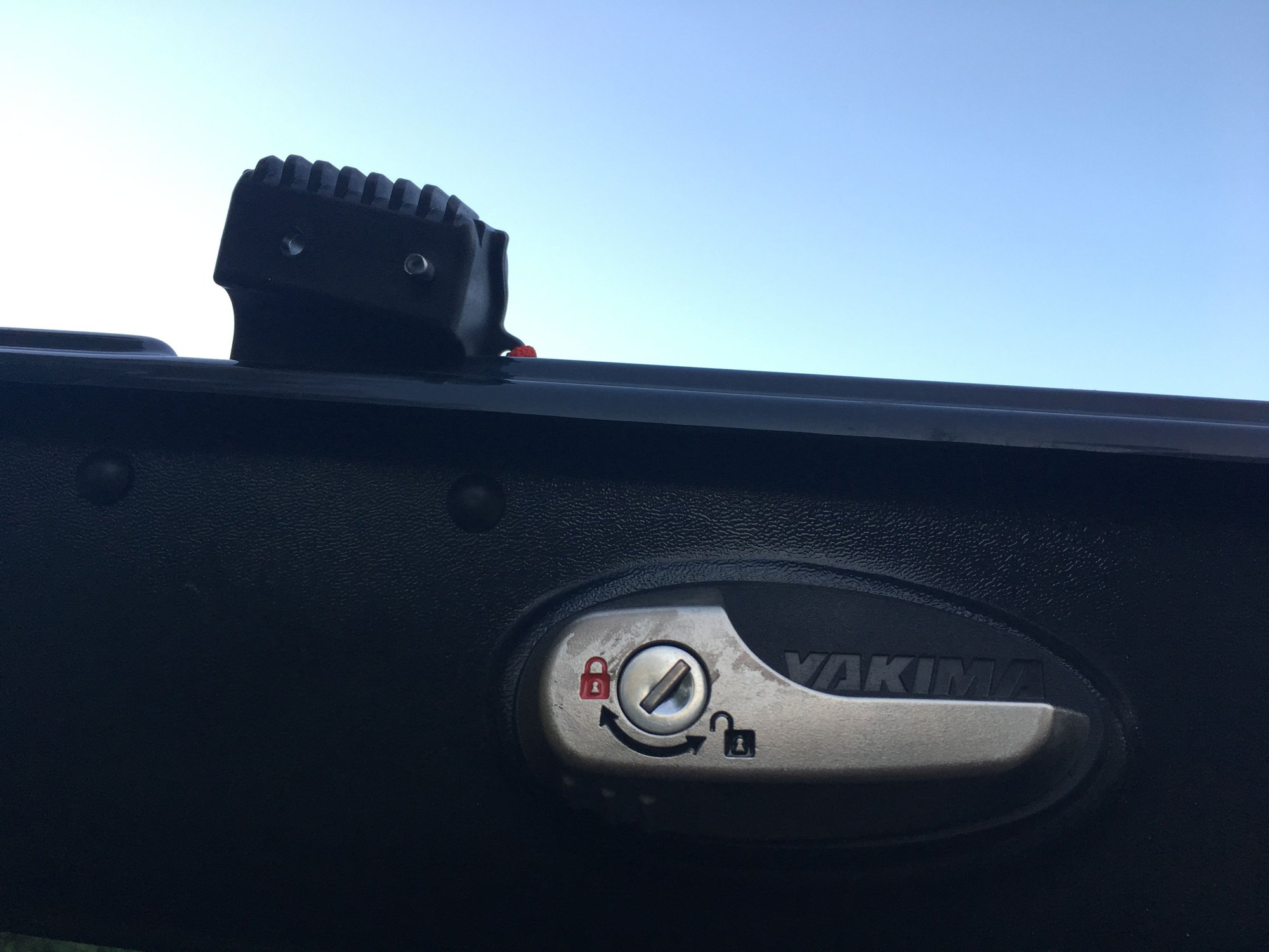

Driving a 30 year old 4runner on roadtrips, you tend to be prepared for most things that can go wrong. Well, not this time. I was 4 hours into my trip cruising at highway speed when a crosswind hit my vehicle and tore the lid off my Yakima Skybox.
Yes, the lid was shut properly -- had survived a 4 hours on the road up to that point just fine. Just as the crosswind hit, I heard a low rumble and then a 'thunk'. Next thing I saw was the lid to the box twirling in the wind behind me.
Thankfully, none of the contents blew out (toolbox, an ax, folding chairs and firewood). Any one of them could have killed someone.
Ironically, this happened in Yakima WA on the way to the NW Overland Rally in Plain WA.
I called Yakima on Monday and explained the situation and they were not phased. The customer service agent said that wind is an act of God and not covered. They were not willing to replace the box for free. The 'best' they could offer was 50% off a new box plus shipping (which eats up most of the 50% discount).
Pretty disappointed in Yakima. Thinking it may be time to switch to Thule.
The lid survived in one piece. All of the rivets pulled out.<br/>
Here's the base still secure on the roof of the 4Runner.
Close up of one of the latch arms that used to attach to the lid. One of the rivets is still in the arm.
Front shot of the rig with the base still on

None of this should be necessary for a $500 product built for highway speed and wind. I have full confidence that my car doors won't blow open while I'm driving down the road - I'm not tying ropes around them just in case. This should be no different.

I'm pleased to report that Yakima and I reached an agreement yesterday after I shared my story on their Facebook page. They will be providing a free replacement for my skybox. For any long-haul highway treks, I'll likely be putting a strap around it for extra insurance from now on.
