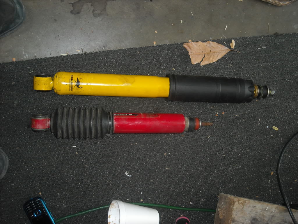

Old Apr 6, 2012 | 11:34 AM
ChefYota4x4's Avatar
iTrader: (5)
Posts: 19,281
Likes: 21
From: Lake Havasu, AZ
This is where ARB-USA sent me shocks for the rear of a 96-01 4Runner for what was supposed to be my front shocks on an 87 4Runner! lol.........
They fit....... BARELY, but I ended up selling them to someone with a 97 4Runner, a buddy, and getting them replaced, too(ARB rocks! They didn't even want them back )

Better pic once I replaced that Output shaft trans seal and cleaned her all up with new suspension/grease remover, lol..... These are the WRONG SHOCKS that ARB-USA sent me.......They couldn't believe I got them to fit! hahahaha... Luckily, I got them out before they were damaged and a buddy got em! ......
