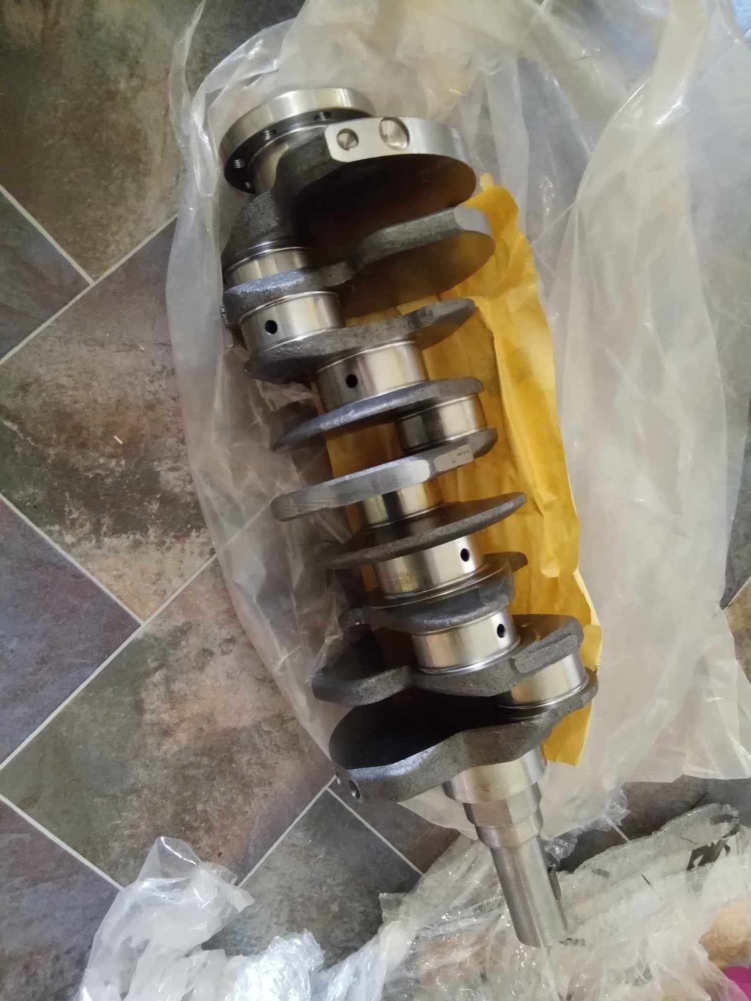

Camry crank has turned up. Looks good so far. I went through my 5VZ-FE fsm document today and I could not see the torque settings for the mains girdle bolts or the pattern for undoing them? When this block came in the box the girdle was already bolted in to it and they feel torqued up. Do those bolts need to be replaced after a torque cycle ? Not sure if the block comes like that from factory?
