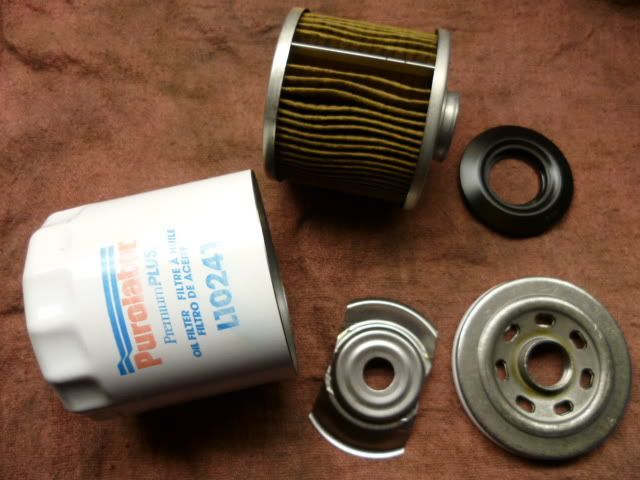

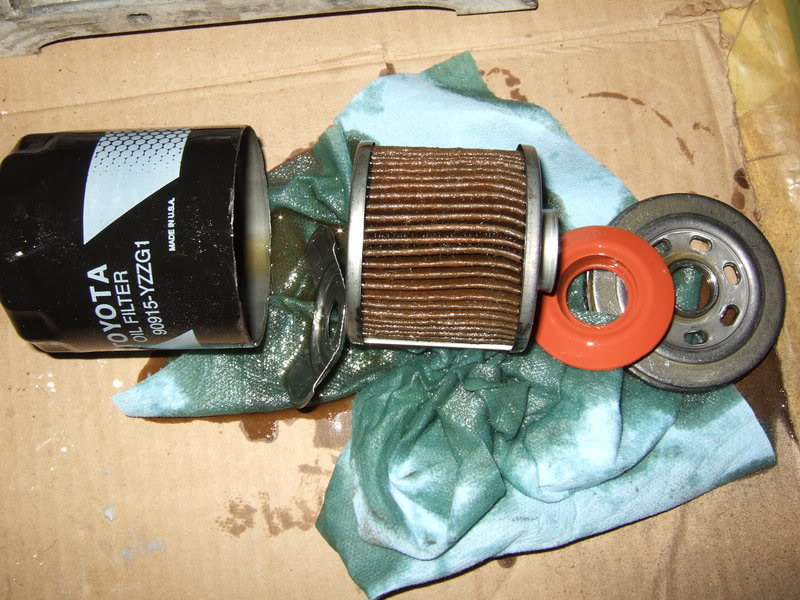

So it looks like the Threaded End Bypass is the way to go to me.
I just wish I could find the exact specifications on Toyota's filters. It would be nice to think I found an alternate filter that has at least the same filtering capabilities with a better Anti-Drainback valve.

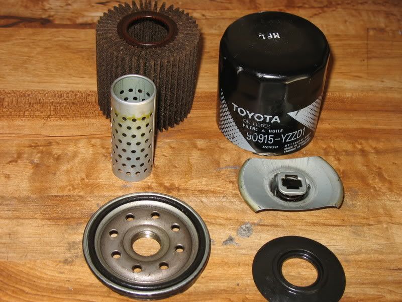

The old company I worked at actually had an engine failure in their large Volvo delivery truck that was related to a bad bypass valve. They had the service shop take a look at it and they reported back with their findings. They said they had found that the oil filter's bypass was far too weak and was allowing all the oil to blow right by the filtering media. They gave the oil filter back and I saw it. That relief was really really weak, it had to be defective for sure. -Not so bad if you've got clean oil but on a delivery truck that probably spent at least 10 hours a day on the road this isn't going to happen.
They also found the air filter hadn't been changed in a long long time returning the black air filter and *THEIR* departments service records to back it up.
They said all those large contaminants from the air filter were being sucked right into the engine and since the filter bypass was toast none of it was getting filtered and all of the moving parts were getting ground up.
This is the bypass type that failed
Diving in deeper with Toyota Oil filters
You can see from this picture other than being on the short side it looks like a decent design with metal end caps and a Red Silicone Anti-Drainback valve. It's what most would regard as a good quality filter..
What's there not to like?
To me it actually looks like it was built by Champion Labs because it's awfully close to a Purolator L10241 with the addition of a Red Silicone Anti-Drainback valve. That's not too surprising because Motorcraft and Mopar filters were/are also produced there.
Also note that the word DENSO is NOT present on the YZZG1
Now take a look at the YZZD1. It looks identical to the YZZD3 shown below, it's just shorter. Again, what about bypass pressure???
Now take a look at the highly thought of (but discontinued) 90915-20004 filter (far left) side by side with the YZZD3 filter. You can see they changed the design on the YZZD3 in several ways. To me the 20004 looks like it would do a better job of holding the oil, but who knows.... I'll bet as far as filtering goes it would also come close to the PureOne filters.
Again, look at the Anti-Drainback setup on the Fram. Notice how the sealing surface of it and the 20004 filter is curved towards the filter media instead of away like the YZZG1, YZZD1, YZZD3, DENSO and Purolator? It might be a stretch but perhaps this has something to do with how well the Anti-Drainback valve holds the oil at bay?

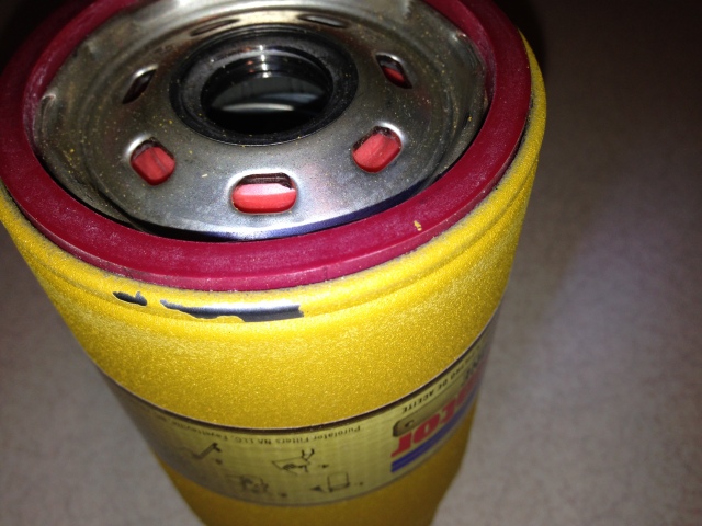

The cross from the Motorcraft FL-400S to Purolator is the Classic# P20195.
Remember the bypass and the anti-drainback valve isn't the Clean Side design
It has been mentioned that the Purolator Classic offers slightly more pleating material for slightly better filtering. Then there's always the PureOne PL20195 that offers even more filtering but it's at the cost of greater flow restriction.
However, for the last two years alot of people over at bobistheoilguy have been posting about the Purolator Classic and PureOne tearing the pleating material which constantly lets unfiltered oil into your engine. There's also several reports of the yellow/gritty paint being oversprayed onto the mounting surface of the filter and some inside of the filter... Not good.
Many have sworn off the Purolator "Branded" products for now.
A Purolator rep was on there a while ago and admitted they have a problem and are looking into it. When a rep admits there's a problem it's not a small issue because it can damage their reputation and hurt sales.
