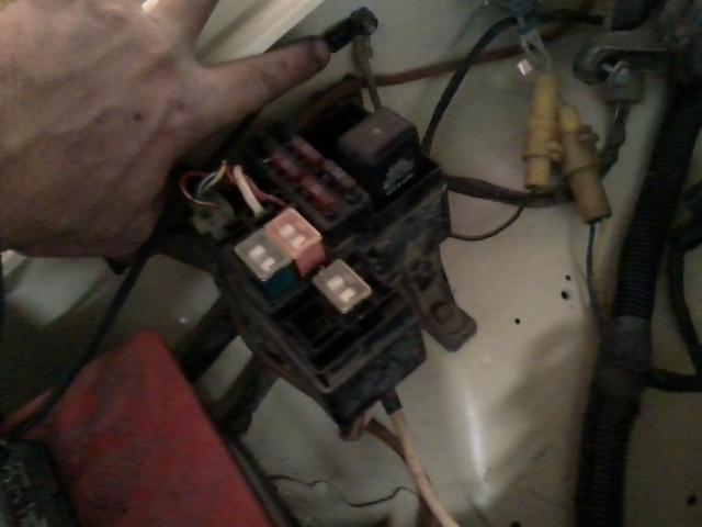

Great write up on the oil filters. I am not sure that Toyotas filters are as good as they used to be but I use them and last time I was into a motor I had that had several miles on it, I was really happy with how well the motor looked.
I adjust my valves to 7 and 11 as by the time I get the cover off and all the other things the motor is too cool to go with Toyotas 8 and 12. I use a mechanics stethoscope when the motor is running to get an idea of which valves may need more attention then the others. Listening on top of the valve cover kind of gives you and idea.
On the grounds, I take a wire tooth brush and get the paint off of the grounding points, on the body.
I got the following ground wire upgrade off of RAD. I mounted the wire coming off of the battery ground to the headlight harness ground. You need to open up the harness a little bit to get the battery ground to the headlight harness ground. I feel it just helps eliminate on more ground area and give better return to the battery
I might just have to try that one.
