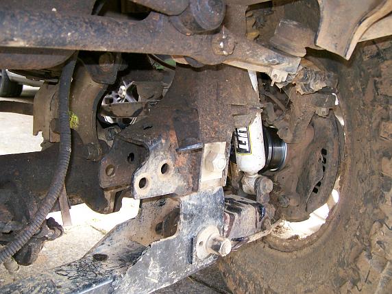

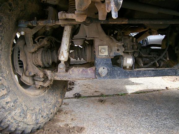

Here are a few pictures.

Is this first picture the bump stop?
And another picture of the diff line up. The diff seems a bit higher, but it wheeled fine for a couple thousand miles with the torn boot. Then after the whole jump thing in the snow, it won't even "wheel" for a couple miles. . .

And in the 3rd pic of post #6... I see no drop spacer for the torque arm...

Jaino240, he's got a piece of plate there... Not the drop spacers like I'm used to seeing...
It's there...

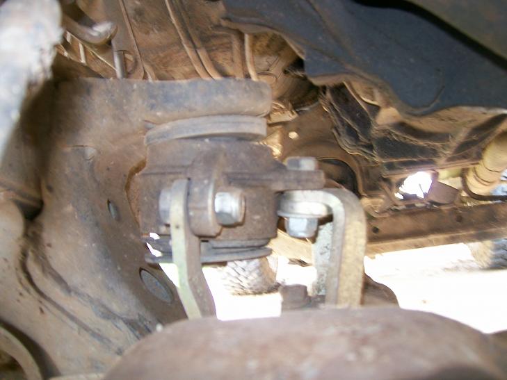

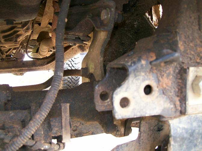

Posts: 9
Received 0 Likes on 0 Posts
In this first picture, are these the bump stops?(not related to stearing) There is one on the right side of the shock, one on the left of it, and a "rebound" stop on the left of the shock up higher than the compression bump stop.
The other pictures show the drop brackets. Do they look right? They seem a bit bent maybe. . .
If these are the issue, why does the old axle work and not the NAPA ones?

Old 04-04-2010, 05:23 PM
tried4x2signN's Avatar
Join Date: Jul 2008
Location: Nashville TN. I can help you if you're close BUT NOBODY CAN HELP YOU IF YOU DON'T FILL YOUR LOCATION IN!
Posts: 1,818
Received 4 Likes on 4 Posts
Originally Posted by Motorider
Are the bump stops there to stop the "A-arms" from moving up to far upon compression?(is there one for rebound too) The part just below the stearing stuff, and to the right of the shock in my picture? It's hard for me to reference where your picture is on the pickup.
I get NOOB questions about motorcycles a lot, so I know how it can be and really appreciate your help!
The UCA does not change locations, so it's bump stop remains in its factory location...
