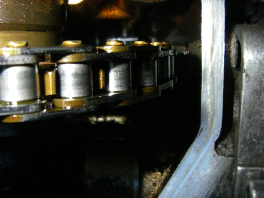

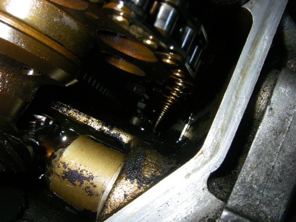

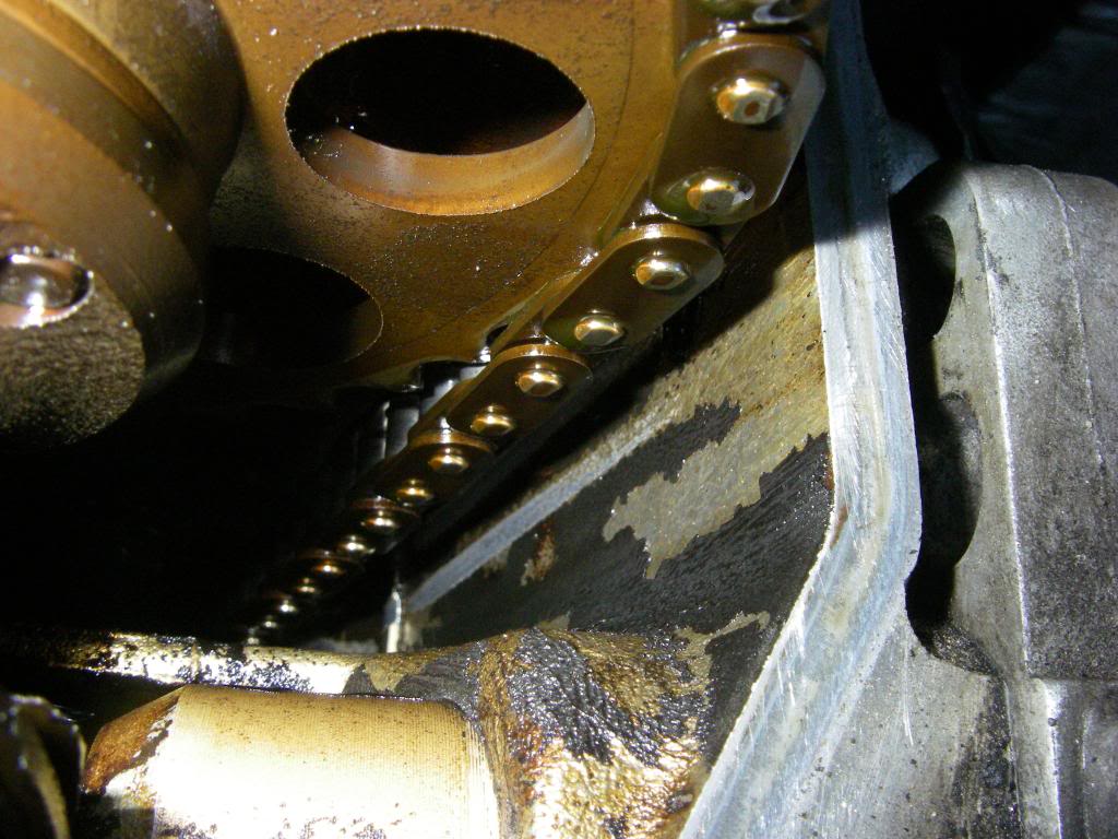

Hello,
This is my first post here, but I've done my best to search for an answer and haven't found much. I've got a 1991 yota pickup with a 22re, and I'm due for a timing chain replacement. I pulled the valve cover to make sure, and the driver's side guide has split down the corner of the guide, so it's in two pieces, one of which is rattling against the cover (but still there, resting against the side of the cover, as far as I can see) and has allowed the chain to go slack. I am going to have it replaced in 5 days (soonest I can get it done).
My question is whether I can afford to drive it approximately 120 miles until I get it replaced (2 days of commuting back/forth to school). I have posted some pictures I took of the wear that the chain is causing on the side of the timing chain cover below. I'd estimate that the wear is less than 1mm. It looks like it's only got through the layer of (oil residue? paint? not sure what the black stuff is), and hasn't started to erode the cover all too much.
Am I taking too big a risk driving it that much? I've probably put around 300 miles on it already since I started hearing the rattling.
I greatly appreciate the help!

Do you feel lucky??
If so keep driving the worse that can really happen is the chain eats into the Coolant passages .
The antifreeze mixes with oil which takes out the bottom end which could cause the engine to just seize at the worse possible place.
Comes down to a timing chain set or rebuilding the engine
Also a lot of other minor things that can do interesting things

The best time to change it is BEFORE it eats thru your coolant passages and timing case...

Now another little interesting factoid it will be a toss up if it stops from the mechanical failure or the heat first .
So let us know just what happens.
it could be so bad the manifolds starter alternator minor things like that is all that is able to be reused.:jessica::jessica:

Ok! It will not be driven until it can be changed, except to drive it down to the garage!
I really appreciate the advice, and I'm sure glad I asked! I'm obviously quite new to thinking about engines, so this really helps.
So, given that amount of wear, should I also consider having the timing chain cover replaced?
Also, solely out of curiosity (I swear I'm not ballsy enough to take the risk and drive the car more, I'm just trying to understand this thing), does it have to eat through the driver's side timing chain guide first, then blow through to the coolant, or can it wear through the timing chain cover without going through the guide itself?
One more thing: along with the timing chain set, I'm also going to have the condition of the head gasket checked, and replace the water pump, but are there any other services anyone might recommend having done during a service like that?
Thanks again for the help!
