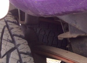

I am using my truck to haul water, it is a 22r engine, with a lift and possibly a beefed up rear suspension, is 2000 lbs to much for a truck this size?
I will try posting pics with another device

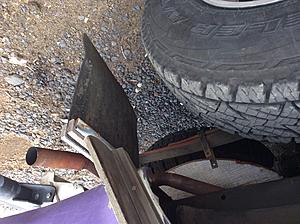

More pics
There is a couple of pics of the leaf springs with bout 240 gallons of water on the rig

How are your brakes?

Yes, that is a concern, they lag a lot.
Thanks for that
I will try using a trailer

You're going to kill the arch in those springs going negative like that.

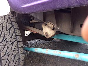

And see how close the bump-stops are to each other? A lowered ricer-Civic can go over a speed bump better than your truck

yeah, the delayed braking is a big concern as well, I will go back to one tank at a time(120 gallons). When I get my trailer going again I may try two tanks in that.
​​​​​​​ Thanks

good point, thanks Jake
