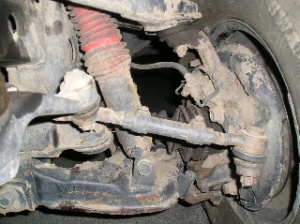

yesterday my truck started doing something wierd... everytime i push on the brakes my truck wobbled kinda viciously, so i parked at my girlfriends aunts house to see whats wrong... and my front driver side wheel is like this --->
[]===\ \ also whenever i turned right it was like the brakes were engaging themselves on just that tire... so something HAS to be broken/rubbing or whatnot.. its an 88 4runner IFS i have pictures but i cant get them to upload at the moment, what do you think?
Attached Thumbnails tire and wheel about ready to fall off- help-pictures237.jpg   tire and wheel about ready to fall off- help-pictures231.jpg   tire and wheel about ready to fall off- help-pictures230.jpg

Old Jul 6, 2008 | 01:36 PM
88Yota4runner's Avatar
Joined: Dec 2007
Posts: 124
From: Yakima, Wa
ok i got a few pictures up on my first post
Old Jul 6, 2008 | 01:42 PM
TOYOTA 1's Avatar
Joined: Feb 2008
Posts: 2,799
From: oregon
looks like the wheel bearing to me!

Old Jul 6, 2008 | 01:47 PM
TOYOTA 1's Avatar
Joined: Feb 2008
Posts: 2,799
From: oregon
looks like the tire was getting close to working its way off..
