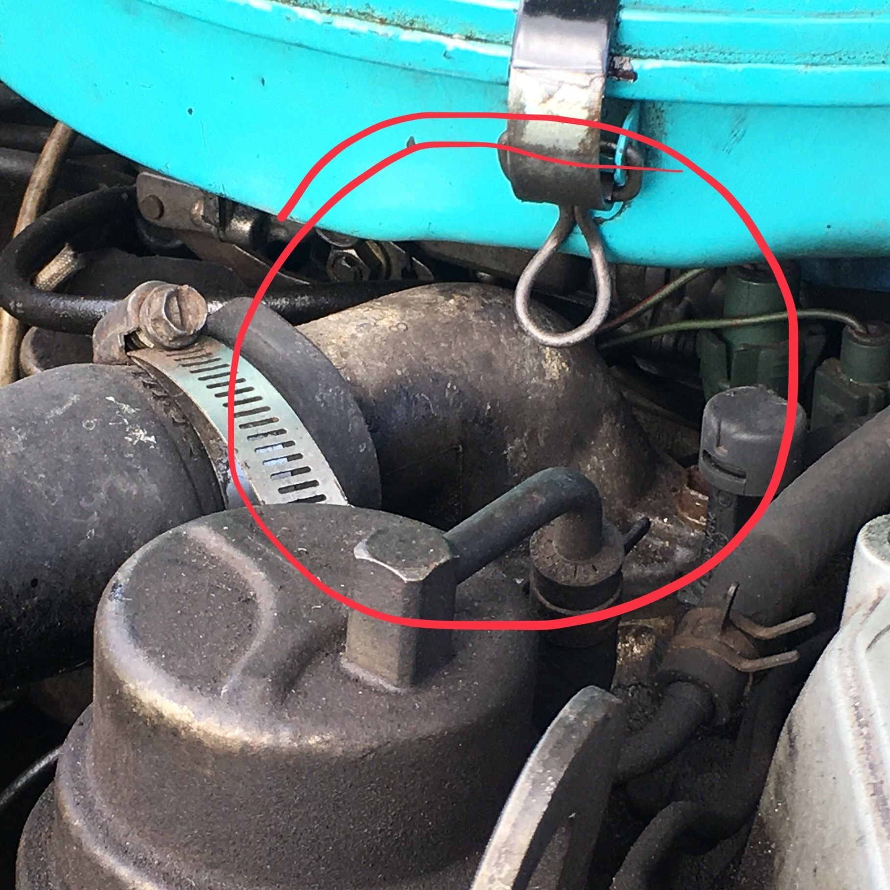

Old Apr 17, 2020 | 04:02 PM
rubronthroad's Avatar
Joined: May 2011
Posts: 312
From: Hawaii
Thanks, is this the elbow above the thermostat that you are referring to?

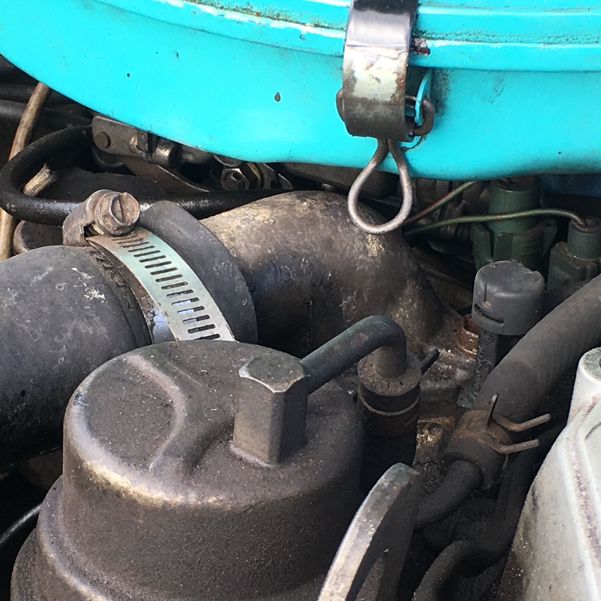

Old Apr 17, 2020 | 04:05 PM
Joined: May 2011
Posts: 312
From: Hawaii
To clarify
Old Apr 19, 2020 | 01:43 PM
2ToyGuy's Avatar
Joined: Jul 2005
Posts: 2,345
Likes: 657
From: Chiloquin, OR
Yes, that's the critter
Easy to get to, just pull up the air cleaner, and 2, 12 MM headed bolts. Pull the hose off, and voila, you have a metal tube you can drill and tap, then wash thoroughly, without any chance of getting metal bits down into the water system. You only need to drain a quart or two out of the radiator to get the water level in the system down below the elbow, so you can remove it without making a mess, and losing that much water.
By the by, the bulge I see in the hose is an indicator that you NEED to replace that hose, at the very least. SOON! I would replace all 3 hoses, if it were me. If the one you showed is that bad off, I'd wager they are all that bad, and need replacement. Not that difficult an evolution, although you do need to drain as much water out of the system as you can. No matter how much you drain, however, be ready to get a little water down your arm when you pull the bottom most radiator hose. Happens to me every time. Wear safety glasses under there, too. That stuff burns when it gets in your eyes, believe me. Since I only have one eye left, I am very careful with it
You may need to cut the old hoses to get them off. If you do, cut straight along the direction the hose slides onto the metal it joins. That will let the hose split, and you can peel it off.
Save the water you drain, and if it's clean enough, you can pour it right back in when you get done. Looking at that hose, though, I'd wager the water is not re-usable. I always pour water, whether new or used, through a nylon stocking, stretched over the funnel. It makes certain nothing can get into the system as you pour. Nylons are cheap as heck, although you may get some odd looks when you buy them
Keep an eye on any water/coolant mix you drain out. Dogs and cats, if there are any around, will try to drink it, and it WILL kill them, slowly and painfully. Even in very small amounts. Discard properly. Keep it away from animals!
Finally, while you've got that elbow off, pull out the thermostat and test it. Put it into a pot of water, and bring it to a boil, slowly, Have a thermometer in the water to see the temperature. It should pop open at 180° F. If you have one of the newer, 2 stage thermostats, I can't recall at what temp the small one opens, but I believe the main should open at 195° F. You an get a thermometer that will read temperatures that high at Harbor Freight for about $5.00, I think.
When you put the thermostat back in, check the rubber o-ring on it for damage, cracking, and so on. They cost about $1.50 at Rock Auto. I, personally, rub a thin layer of Vaseline on the o-ring. It helps preserve them, and makes them last a lot longer. Finally, check the space where the o-ring sits when the thermostat is in. It can be prone to corrosion, and you may need to clean it out, before re-installing the thermostat. The Vaseline will help the o-ring seal better, too.
I don't know for certain if it makes a difference, but I always place the thermostat in such a way as to have the little "jiggler" valve at the back, IE: toword the curve of the elbow. On my trucks, that's towords the firewall.
Good luck! I know it all sounds like a pain, but better to do all this at once, than to blow a hose on the freeway, or overheat on a long drive. And those hoses are not long for this world, you can see clearly.
Pat☺
