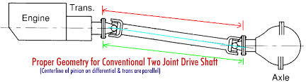

Be aware of pinion flange angles, as when they get skewed via shackle lifts you could have some vibrations. Google, ( rear driveshaft pinion angles )
I will definetly pay attention to that, i haven't looked at my current setups angle, but now im curious.
