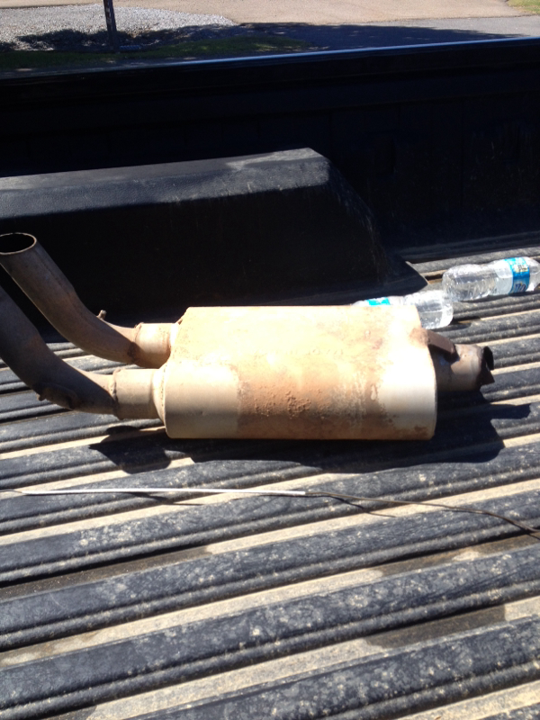

today leaving work I heard a clanking sound so i pulled over and this is what I saw
gotta go after class and get it put back on

i dont see a hangar bar on that muffler (but im lookin at it on my little phone). what is supporting the weight of that unusual dual outlet muffler??
if there's enough flange on that muffler, you can buy a 45 degree adapter pipe and 2 exhaust clamps and fix that break for like $10 with a socket wrench. but you really want to support that muffler with something, even a universal hangar anywhere to the body will work.
unless a shop owes ya for a recent install they did. make sure the muff is supported, not just the pipe in front of it. good luck

nothing was supporting it but a weld to the truck I'm taking it back to him and he will fix it

Looks to me like the muffler just pulled off the pipe .
Like maybe the clamp was never put on or was not tightened .
Both pieces look to clean to have rusted off.
Better to have to many hangers then not enough .
Lack of hangers can put pressure on the manifold causing to to break what a pain to replace.
Good luck

I go tomorrow I'm gunna get the converter taken off and just run straight pipe to the muffler and I m gunna make sure it's not coming off

it just a muffler shop he doesn't do anything else, I got told today that taking the converter off is illegal? I went to him and he said he will put the muffler back on for free, I go at 3. it broke off the pipe, what do you suggest I do?

this is it up close
