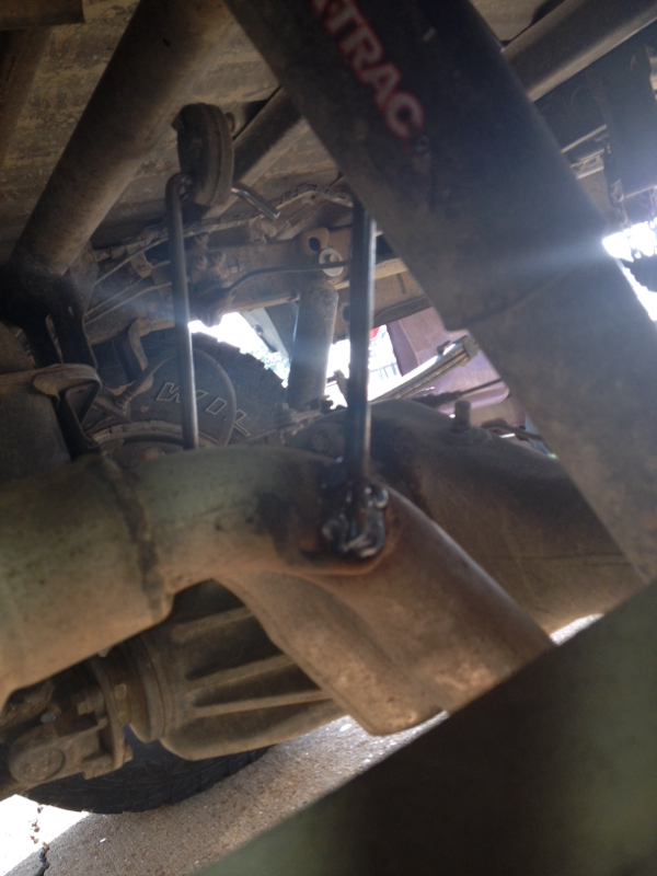

what do y'all think, will this hold? also when he turned on my truck my converter was making a ticking noise like loose metal any idea what it could be?

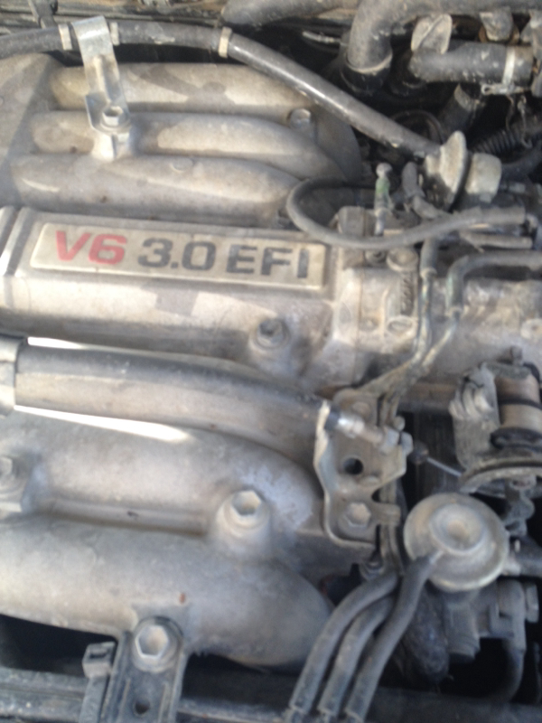

that's what I have on it now and it has a really nice sound to it, it's soothing I'm not sure what kind of engine I have in it maybe you could tell
like I said I'm still learning so bear with me If I can't answer most questions

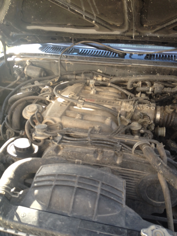

That's the 3VZ-E V6. And if you already have a Magnaflow on there, then you're good to go IMO

Jackie you have a 1993 toyota Pickup. 3.0 V6 engine with a 5spd transmission.
Your exhaust is a Flowmaster 30 series 2.25" inlet with Dual 2.25" outlets.

those are really ugly looking welds on your hanger brackets.
I would keep your eye on them so they don`t break and fall off causing even more grief.
The rattle sound is most likely the heat shield on the converter.
I would guess the double turn down muffler was what they had in stock so that is what you got.

alright I'll keep a lookout, he said it broke off before because he put bad hangers on it.
is there anyway to fix the rattle just for now?
