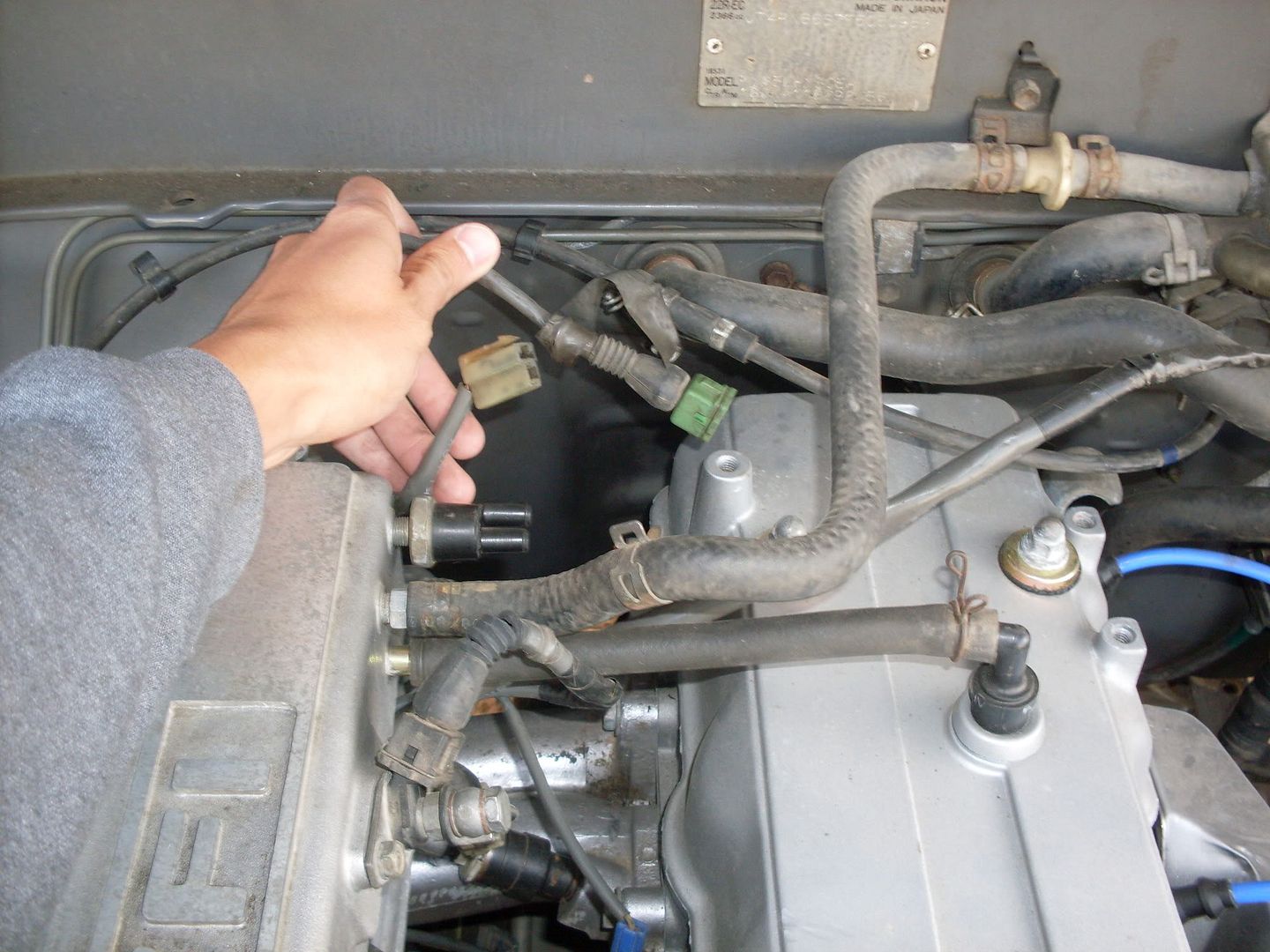

Hey guys, I slowly getting my truck back together/running, its a 1985 22RE w/ newer style intake mani/throttle body. I need your guys/gals' assistance in identifying a couple plugs:
I know the green plug goes to the VSV for the FPR, but I'm not sure what the white plug is for that I'm supporting with my middle finger through pinky.

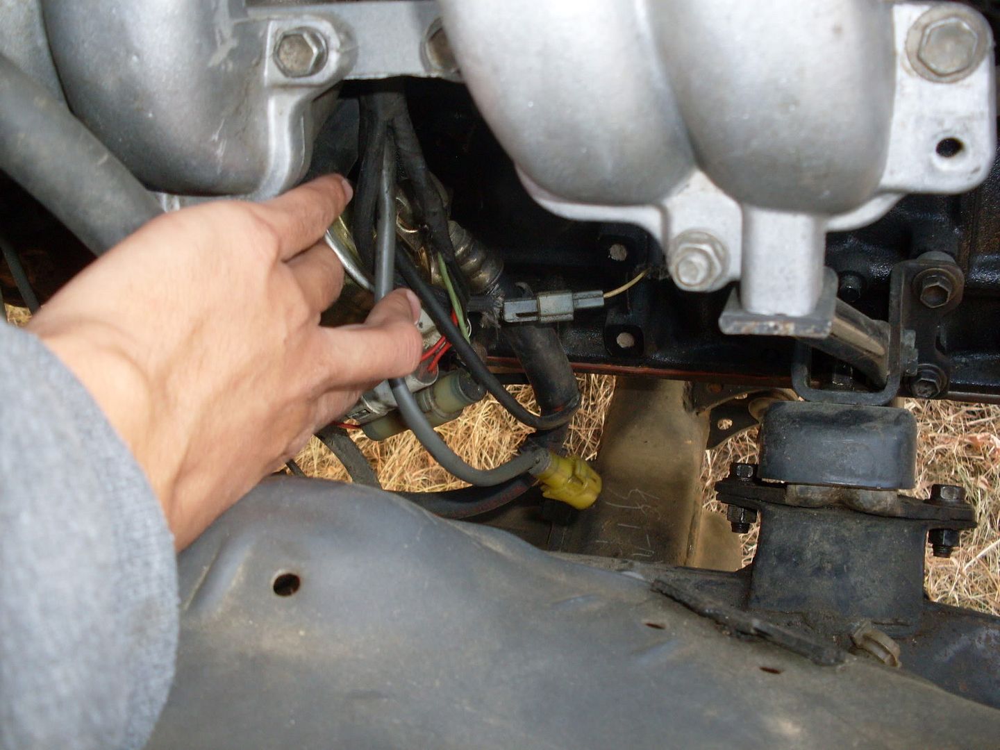

Where does this clip to?

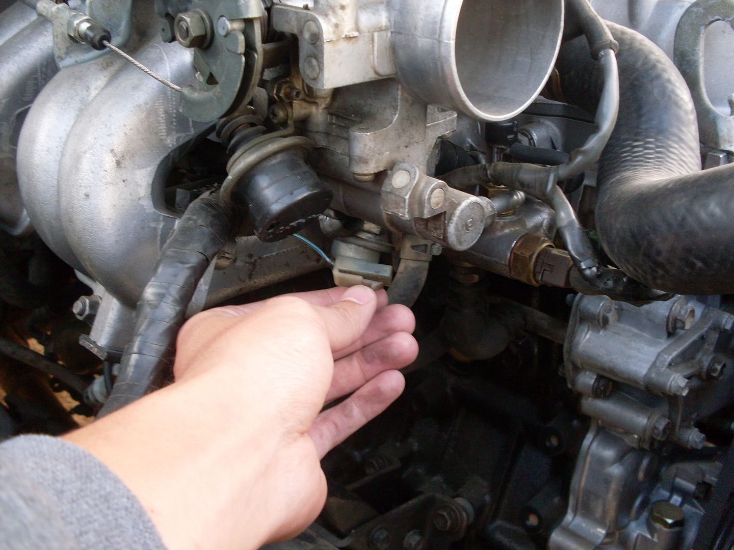

The yellow plug that runs down to the cluster of wires near the starter.

first pic, green plug os for one of the vacuum switching valves on the valve cover, and IIRC so is the other one.
2nd pic is for a/c compressor magnetic clutch
3rd pic is knock sensor.
