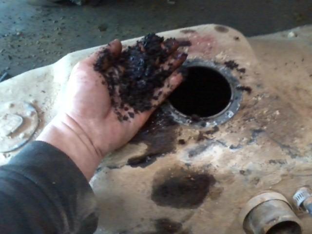

Personally I like Seafoam. Not sure what you would accomplish running thru the Intake system cleaning that area up with constant use. I do not suggest running it thru the tank. Do a search on Rusty Tanks. What looks like rust in a tank, in my opnion is a build up of chemicals from the additives in the fuel. It does look like rust but I have cleaned tanks and there is no pitting from rust, looks like a new tank when done.
I have removed 3 pounds of crud from a tank in the past. That is just to much junk for your filter to stop. I know a member on here that got his injectors clogged when running cleaner in the tank. The tanks that are rusted to me are the ones where mud has sit on top of a tank and rusted holes thru.
I run it thru the Intake system once or twice a year or on a new to me truck for the first time. I do not use in excessive amounts. Normally one can is all I use.
This tank filled up a Folgers Coffee can with the gunk in it.
