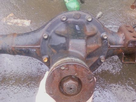

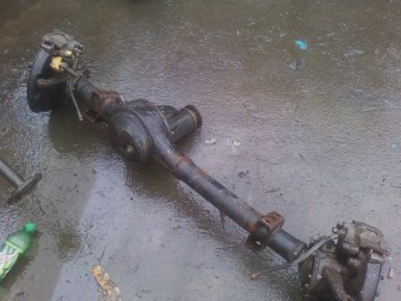

I had a question aboy sas......could you use a Suzuki frunt axle for a swap? there was one at the junk yard and it looked pritty good. thank you for your time and help.

Sure, you could use it no problem.
In fact, those will even be easy to get parts for since most Suzuki owners swap their axles out for Toyota axles (something about bigger, stronger, less breakage?) so there should be a ton of suzuki parts available.

You'd have to google it or find a 'zuki site to ask that. Junkyard mathmatics say that if you spin the ONE side twice and count the pinion turns and then divide will give you a ball park ratio.
again...theres a reason why 'zuki guys swap for Yota axles...

the suzuki axle is a pile. If you want cheap find a dana 44 from a wagoneer or cherokee chief. they are narrower than a fulsize axle. Generally the six lug versions had the driver side input and the five lug versions had the passenger. I believe you can swap the steering knuckles though and wind up with a six lug passenger side input. Don't waste your time with the suzuki axle.

Dont waste your time and money going backwards with the Zuk front...go Toy axle
Sami guys swap OUT zuk axles for Toy axles.....

well i had taken mesurements and langth wise the axle would fit.......
other then beeing weaker what specific areas are problematic for that axle.....they are giving me a deal that i cant resist.

Just because it's cheap doesn't mean its a deal. You're not listening to any of the other posters! You don't want that axle for a swap, you're better off staying IFS!
