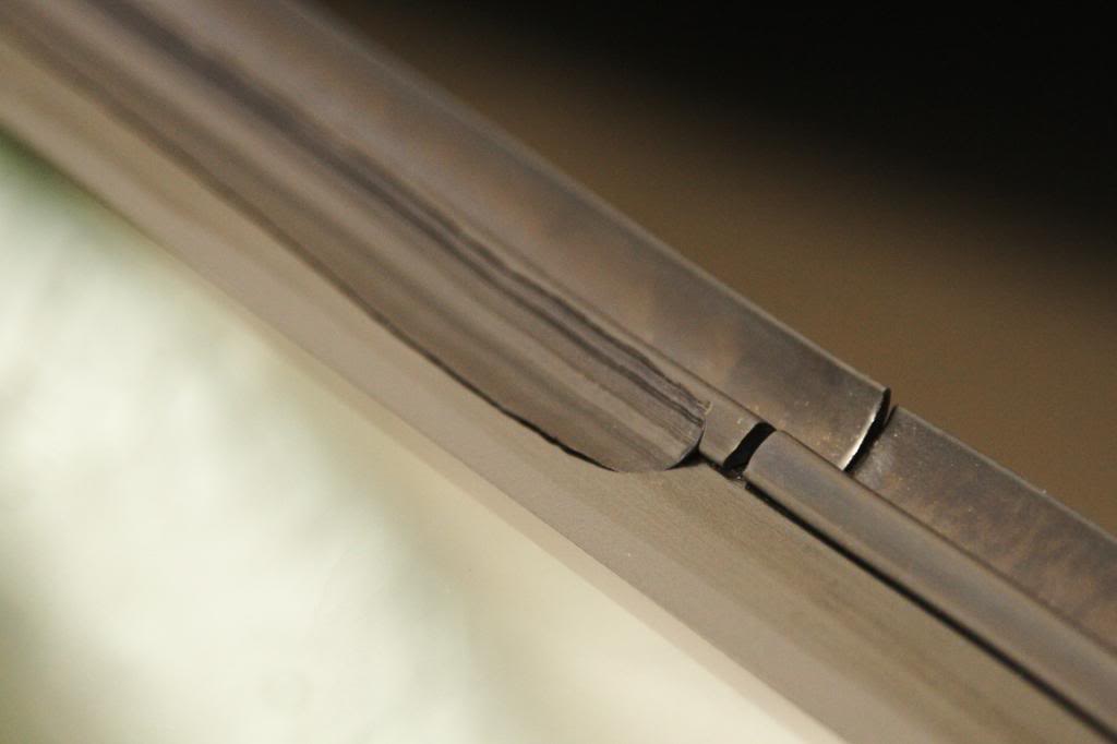

Tnx for all these inputs, guys! I observed the Safelite tech as he installed everything. I think he did an excellent job, is very personable and helpful. Below he put a thin bead of urethane adhesive at interface between rubber and glass. That would be further filled with adhesive as the good size main "V" bead he put squeezes out.
Re Silicone:
I got DC 995 but at last minute, I mentioned it to an aircraft mechanic friend. He mentions what could be the good technical reason for not using silicone as windshield adhesive. It is not about lack structural strength, but about a solvent or other substance in the silicone that I believe is acidic- Good for glass but not for metal.
So I guess now I'll need to research where to find exactly same urethane adhesive that the shop uses to fill that gap.
