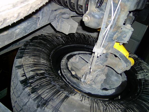

If your rear axle seals have not yet been replaced they are a common trouble area-when they go they tend to soil the rear brake drums and shoes so prevention is a good way to go.

this is how messy the drivers side rear axle seal looks when it blows. Mine was actually done twice before the correct part was used-be sure the part number ends with digit #6 if you get this done.
