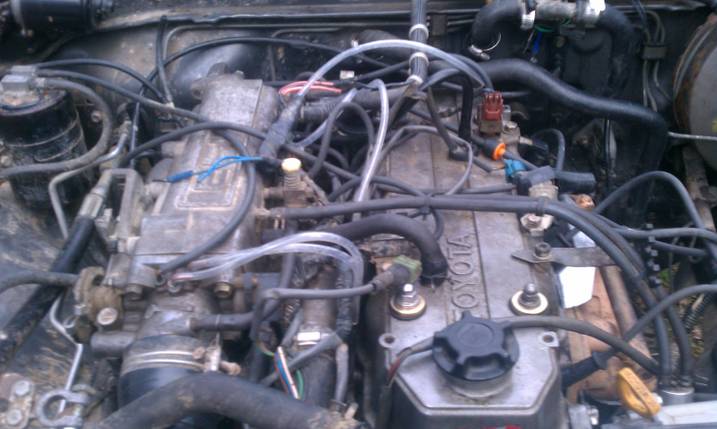

This is the unplugged plug (the green one right by the valve cover bolt). I've tried switching it with a black one that has the same shape with no luck. I'm thinking now there was residual carbon on the heads that's preventing the valves from closing all the way, or hot spots on the pistons are causing predetonation. I'm going to try adding octane booster to the gas today and checking the knock sensor connections. Hopefully it changes something.

that one goes to the sensor in the front of the lower intake plenum right next to the brown one.
the plug shape is different in this picture but it shows where it goes.
Picture courtesy of YFZsandrider.

Yep, Coolant Temp Sensor, very important and could cause some issues for sure, not being plugged in.
Far as 0*BTDC.... NO, that's not correct. 5*BTDC is the actual factory timing spec for these(unless you have a beefy cam). Start the motor, then jump TE1 and E1 plugs in your diagnostic port..... Then set timing to 5*BTDC.
I know it seems hard to believe, after TRIPLE CHECKING things, more than once, lol.... But trust me, it's possible to have the dizzy off a tooth and have serious issues, yet looking it over it seems perfect. If you put the dizzy in at 12'o'clock(the rotor pointing/12), as you slide it in it should fall back to #1 Spark Plug Wire Local. You should see a 'notch' in the dizzy drive gear, a dimple rather, just before/counterclockwise from/ where the gears contact each other(Cam and Dizzy Drive gears).
Far as the timing marks.... That's crucial that it be done before slapping the cover back on, etc..... and with the CAM gear Notch at 12(dimple at 11:59) and crank mark at 6..... you should be golden, granting you get the dizzy in just right before turning it over AT ALL. HOWEVER,..... The timing being set without the TE1 and E1 being jumped, as I said, will also give you an inaccurate base time.
Not sure if you have an IACV on this, but that also has a light blueish, sometimes green connector that connects to it, behind/under the throttle body(IACV has 2 large vacuum hoses coming off it and coolant lines as well).
Now that you have the firing order just right and you're CERTAIN you have the chain installed correctly.... it's just a matter of 'gremlin hunting'... and trust me, I can tell you about that! hahaha.
Plug in that coolant temp sensor connector and make sure the one next to it(Cold Start Injector Time Switch) is connected as well.... and then go from there with the timing, yeah?
Ok thanks that's what I figured. I read that could be causing me problems. What's confusing me though is there's two sensors (cold start is brown and coolant temp is black) but three plugs, one green, one brown, and one black. Looking at those pictures I'll try the black and green instead of brown and black. Where does the brown go?
