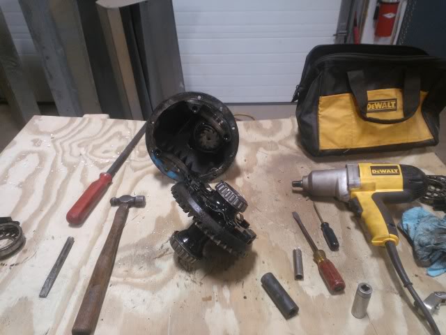

Noting says cool like a spool.
If you plan on doing alot of pavement driving, I would skip the spool. It will wear down your boggers fast. But if its a mud only. Go for it!
You dont want to use the 84 rear axle, its 3" narrower than your current axle.
