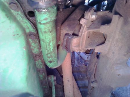

I did just notice that the drivers side motor mount isn't broken, but it looks to have moved upwards about an inch. I will post a picture of it when I can, but could this play any part in the carb not getting the proper fuel levels?

I will look into the fuel pump and start there. Here is a picture of my drivers side motor mount. I know I need a new one so I was thinking about the Trail Gear mounts. Anyone have any other suggestions or any good/bad stories about a certain brand?
