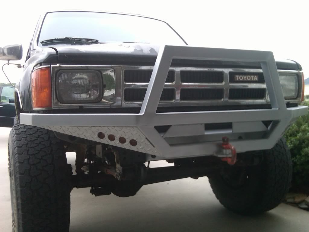

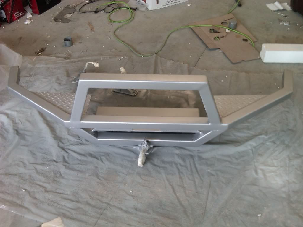

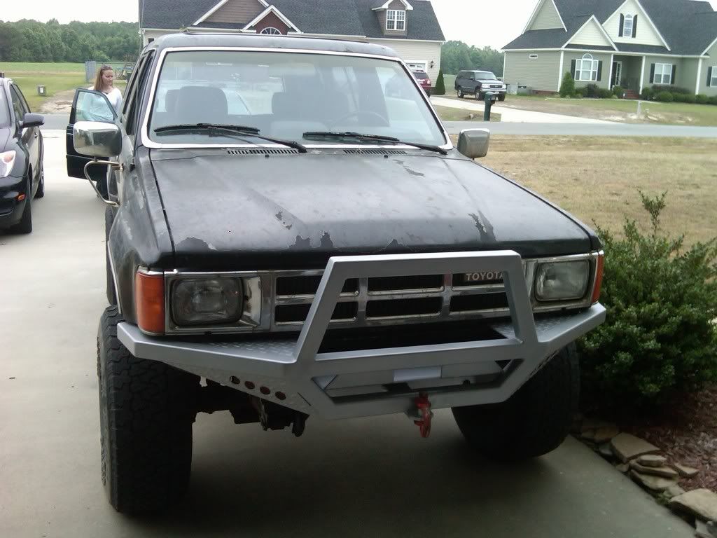

well i havent had the time to take any good pics of the new bumper with my good camera yet so these crappy camera-phone pics will have to do...
this is before paint picture #1
this is pre paint pic #2
painted but not installed
painted and installed #1
painted and installed #2
so there you go...sorry for the cliff hanger...

should my springs look like that? (last picture)
Not at all, but that is what happens to stock springs after 25 years haha. When you get your new lift springs they will have a nice arch to them.
I like the bumper, you dont really see anyone go with square tube on a front bumper. I think it looks great!

Thanks alot! i was going to go with a tubular setup at first but decided against it....

Nice bumper!!!
