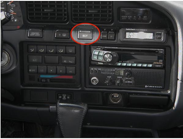

We have this say, button, on my console of my FJ80 and it says 'ETC'.
The button is defunct because we had purchased a LAME car freshener once that clips onto your vent? Well, the airfreshener which was liquid SPILLED onto the dash there and literally melted the plastic around the sides of our mysterious 'ETC' Button so it does not press in.
I looked through my users manual and there is no mention as to WHAT this button even does, so it sits there and stares at us.

on my hilux its the electronically controlled transmission button.. it uses m,ore diesel and keeps revs high for towing..dont use it around town unless you like buying gas

ECT stands for 'Electronically Controlled Transmission'. It changes the transmission shift points, with the button pushed in it's in "Sport" mode. That keeps the transmission in lower gears longer for a bit quicker acceleration.

Mine is in to turn it on and out is off. There is a green light on my dash which say ECT POWER, or something like that when I push the button in.

mine has dash light too

Well, Im in luck- it's off because no light. ANyone have any tips now how to un-meld melted dash plastic from it's buttons? It's... REALLY fused.

you could try thin metal strips between the gaps to free it.
...dunno of any way to reverse the damage.

Ha ha ha. I wish. Wheelin sure we be a lot more fun. I would just duct tape the button down.
I usually use a really small screw driver (the ones you never use) and just slowly work on the difficult spots all around it. Sometimes they have small tabs on the back that don't want to let go.
