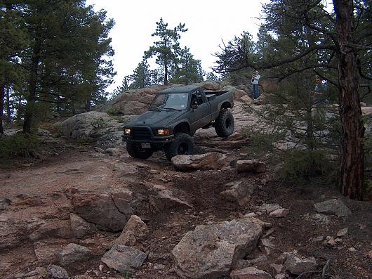

Just got these pics on the computer. We went through Rampart Range and it was a perfect day.
