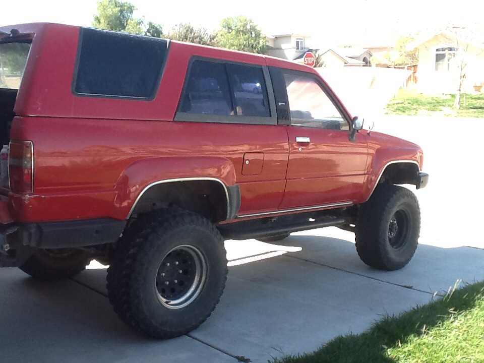

I got ah 87 4runner with ah 4" lift all around was what the last owner said. So if i'm right, if i want too replace the leaf springs on my rig. Would i buy the stock leaf springs or would i go with ah 4" leaf spring? Whats the differences? Still new too all this

Depends on what kind of lift you have now....shoot some pictures and post them up. The guys will know what you have when they see it and make a choice.

kool nice. i'll take some shots. dont know where too start but i'll shot the back area and the two fronts. hopefully someone can tell me what i'm running for sure.

Ok let me know if i need better shots not too sure of what i needed too take a pic of.

Looks to be add a leaf in the rear and torsion bars cranked in the front.
Nothing looks bad or hokey so far. No blocks in the back.
Im weak in the lift dept. So I hope one of the treebashing rock crawler guys chime in.

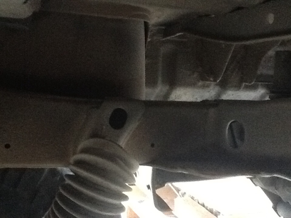

Well after looking at it. I think i just got ah body lift. Looks like the body i guess sitting on some long mount looking things. Like four on each side. Looks like they are all 3in. around. Got more work too do then i thought

I'm not seeing much suspension lift. Hard to tell on the front, but I don't see a diff drop bracket. If anything, they cranked the torsion bars up. And the rear springs look like replacements, since I see a slip pad at the end of each leaf. And they look like they have a divot in the slip pad, which is for using a needle to grease the pads. OME, All-pro, and some other higher end companies did this. The lower shelf companies(Rancho, Rough Country, Skyjacker, etc) I don't believe used greasable slip pads. Some did have pads, but not divoted, injectable pads. TG uses a round pad with a bunch of "nipples" on the top side. I'm not familiar with their older designs.
I am wondering if the front torsions have been replaced. Because it may be that the rear springs are around 2-3" lifted. Because about all the factory stock springs I've seen these days are flat or inverted. If the front torsion bars have been replaced, you may find some identifier there. Or if there are any numbers/letters on the top side of the rear leafs.
After saying all that, I've seen some mix and match varying stuff from different companies. Not sure if the supplier was the same or designs changed. So it's very hard to say with certainty if you have ANY suspension lift.
In regards to the body lift... In one of your pics, second I believe, there is a shot of the front tire/axle area. In the top of that pic is a bolt, a body bolt. Zoom out a bit and show that bolt. Anywhere that the body mounts to the frame. That will let us see body mounts and whether they have a lift "puck" installed.
Just seeing your second group of pics and the body looks spaced off the frame 2-3" or so. The spacers look "coke-can-ish". Tall cylinders.

Ok so behind my intercooler pipe there is this mount and like three other ones that run all the way back. Is it safe too say those are the body mounts? Or where the body lift would be installed.
-yeaps they look coke canish runs all the way back, like four of them.

Yeah thats the side shot of that bolt. Ok now i'm starting too understand this stuff thinkS

Definite body lift. The vertical length of that cylinder is the amount of lift. 3" or so?
