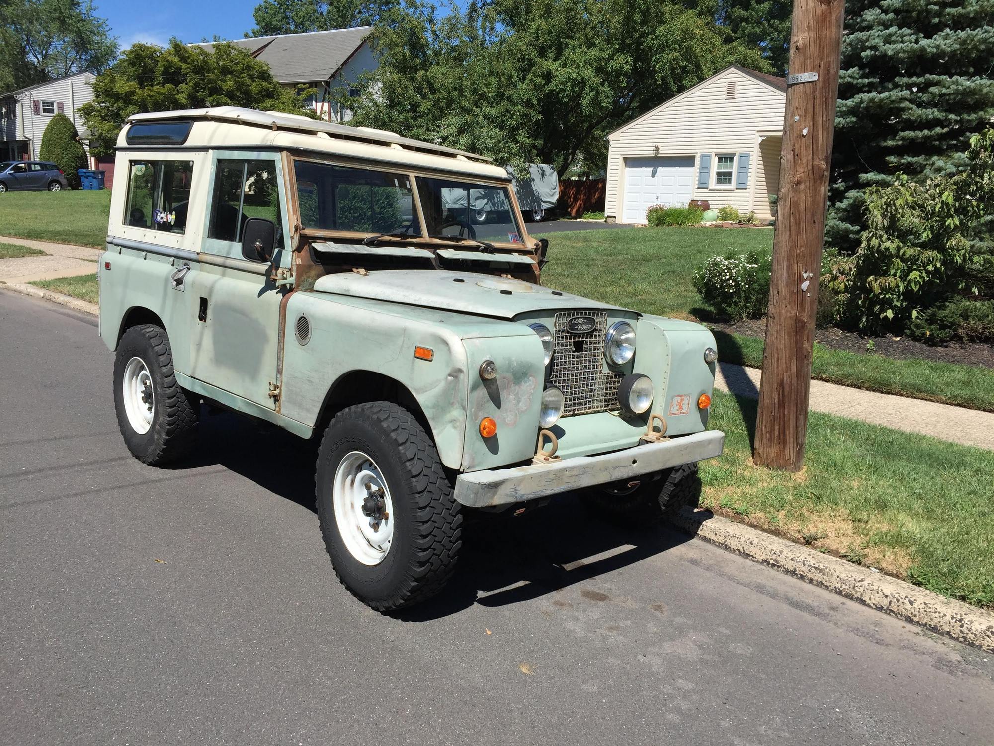

Hi All at Yota Tech. I work on and drive one my Series 11A Land Rovers. The drivable Projecton is a 1969 Series 11A SWB and The Garage project is a 1968 109 Series 11A pickup that I converted too a 3 door Station wagon. I joined this site because there are a bunch of guys doing VW ALH TDI Diesel swaps into their Toyota truck. I am about halfway done with a ALH TDI too a R380/L230 Defender Transmission conversion.
I have just boxed up my scrapped 2002 Jetta TDI wiring harness that I will be sending to Sal at S&P automotiveto make up a new harness for the 88 SWB 1969 Landy. So far the conversion is working out. It is the harness that needs to be done. Then the engine mountings and also the transmission mountings. The length of the drive shafts will have to done after the motor and tranny are in place.
Mods too the 88 so far. are ARB air lockers front and back with 4.1 gears from GBR in Salt lake City. The axles are from a '97 LR Discovery with spring perch modification to sit on the Parabolic springs in the truck. These axls give the truck disc brakes all round making the brakes 300% better than the drum brakes it had. The axles ar 4 inches wider than the original axles which also gives a better turning circle. The parabolics give a softer ride just a little better than the OME springs. This was taken in PA. I live in Florida now. The question I have for the ALH conversion guys is what do you do about the water ingress into the bellhousing and clutch area
