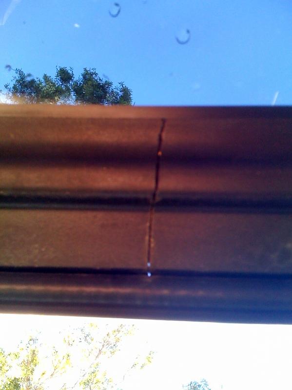

As far as the sunroof is concerned, I got up there with a glass of water and started messing around. Turns out the leak was right in front of me. I thought this crack in the plastic surround was a seam at first glance. Nope. I'm going to take some GOOP to it. I'm just hoping I don't have to buy new glass.
Attached Thumbnails New Owner of 3rd gen 4runner with a lot of questions (Really Long)-sunroof-crack.jpg
