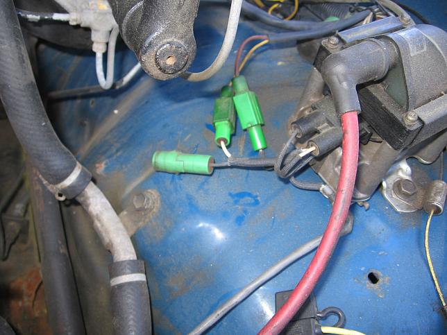

been following lines but cant get the tach to work look like everything is hooked up, some one mentioned it could be burnt out? how is that possible. is ther a way to fix it...

I already answered this, right here:
As far as the tach is concerned, you need to investigate the connection between the coil and the tach. Make sure all the wires going to your coil are connected and have good clean connectors. There are two plugs coming off of the coil in that truck, one has two wires, one is probably round and has a single yellow or white wire. This is the tach sender, check for continuity between there and the place that it should land on the back of your gauge panel. You can search the forums here for gauge panel pinouts, or trace the wiring on the board on the back of your gauges. Also, the FSM should have a diagram showing the two round connectors to the back of your gauge panel, and which wire goes to the coil.
Your tachometer gets its signal over a single wire from your ignition coil. There should be two plugs coming off of your coil, you want the plug with a single, heavy gauge (#12 or #10 AWG I believe) that is coming off of the coil. Disconnect this wire from the coil, identify the position on the round terminal plugging into the back of your gauge panel where the tach signal wire lands. Use a multimeter, measure for continuity between the lead at the tach and the lead on your dash. If you don't have continuity, you have a broken or shorted out wire. It is unlikely that you have a blown tach, the wire from the coil to the dash is "fusible link" wiring, meaning the wire acts like a fuse and blows out if it takes too much current draw. The most likely failures are blown or shorted wire, or a bad connector to the coil. At worst, you have to run a new wire from the coil to your tach.

ok there is a thick brown wire and black wire and yellow wire in the another loom coming off of it, the black wire is not plugged into any thing, the ywllow wire is, and the thicker brown wire is.
now the fsm on ncttora is for a 1979-1985 Toyota Pickup and 4-Runner Gasoline FSM 22R
but show square plugs on their wiring diagram.
not the circle i have.
i dont have a multi-meter.
The circle is, on my rig, the tach sender. My advice - If you don't have a multi-meter, and you want to diagnose electrical problems yourself, go buy one. You can get a low end multimeter at any hardware store for 20$. If you don't much know how to use one, I highly recommend purchasing a digital multimeter, as it will be a lot easier for you to read than one with an analog needle. You don't want to just blindly plug things into places in the harness, this is a good way to blow wires up and start fires.

so to test if that is indeed the tach singal, set it to ohms? and check for input?
i guess the tach never worked cause there is no harness to plug it into...

Hmmm... Did the PO change the whole gauge cluster when he added the SR5 oil/volts pod? Not all of these trucks came with tach from the factory, that is the only thing that would explain the lack of factory wiring for the tach. Otherwise, definitely don't take my word for gospel on the round plug, my coil is slightly different from yours, and the harnesses varied from year to year. This is where testing those circuits with the meter will come in handy, you can identify where they go, and see if one goes to your gauge panel.
The ttora FSM's actually start at 85. Or maybe 84. I tried using that one for a while and it does NOT work for our trucks. Real FSMs are year specific, they don't cover a range of years. One year only. Look for an '81 FSM if you really want some good specific info on your truck, or go into the "Pre-84" section of this site and see if anybody with an '81 FSM will scan you some of the appropriate pages. I don't know why they insist on calling that early FSM '79-85. It's just not true. To date, there are no online 79-83 FSMs. You can either buy a hard copy new, or find one used, but you won't find a downloadable version.
From what I've heard about the 79-81s, even if they didn't come with a cluster with a tach in it, all you have to do is plug in a cluster with a tach, and it should work. Should already be wired for it, even though the truck didn't actually come with a tach from the factory. But on my truck, with the square plugs, I did have to run a wire. So, you should really find out if the tach even works first, because I'm guessing that your truck should already be wired for it, so the previous owner should have been able to just plug in the new cluster and have the tach work.
Yep, but those early round plug models should be wired for the tach, whether or not the cluster has one. Like I said though, this is just something I read on the internet, so....
If it's true though, you should be able to take a truck that came with no tach, get a cluster with a tach, plug in the plugs, and it would all work. Assuming the tach in the cluster is functional of course.
