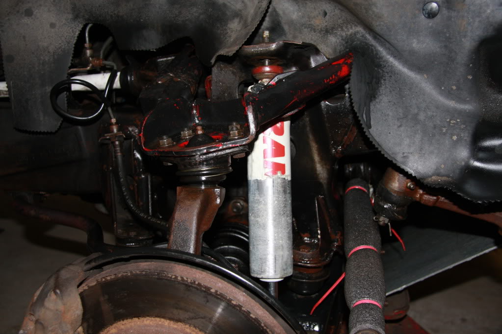

I am tired of Rancho, there shocks rust ASAP.

mm took boots of my front n dang,,,, had to sand m, was gonna paint m but the dampins gone, gettin something new.. dang rust
