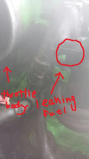

Ok hopefully you can see something on here it's the best picture I could get since it's way underneath there but I circled it and put where the throttle body is and stuff

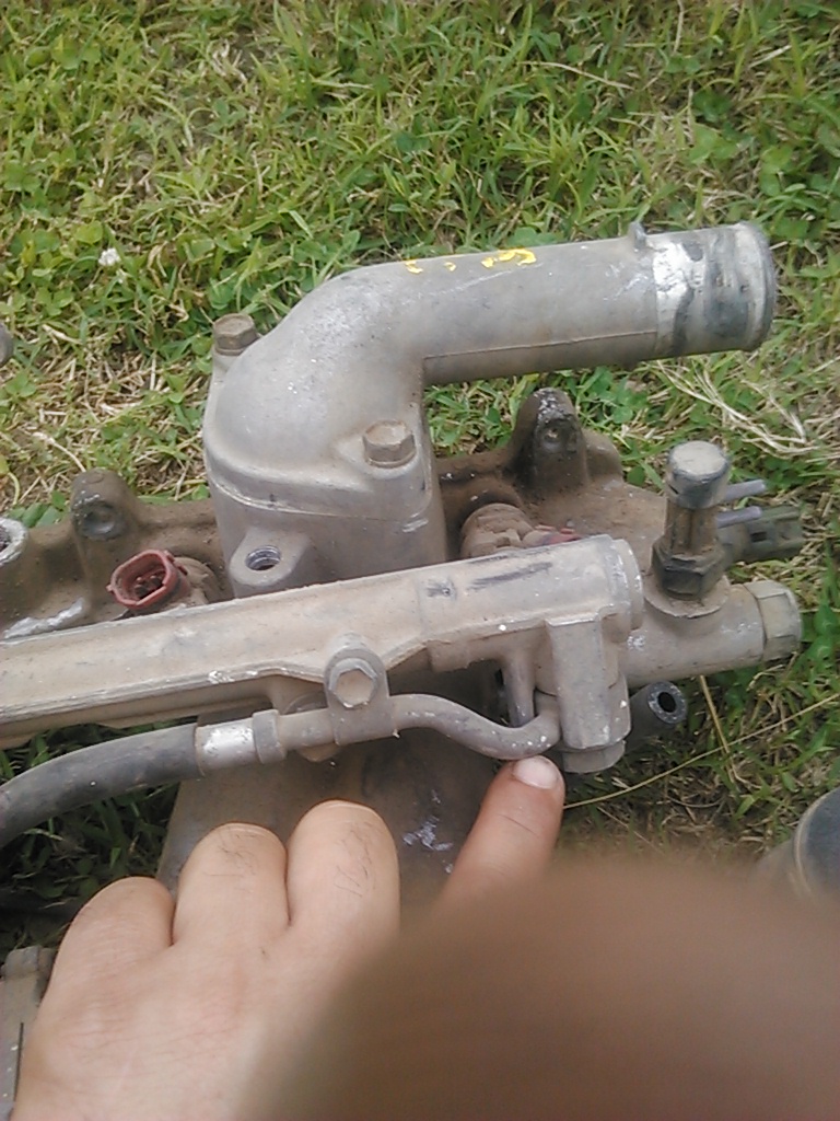

Is this the one you was talking about? It has been awhile since I have taken that line off. Probably some brass crush washers that go on each side of the banjo.

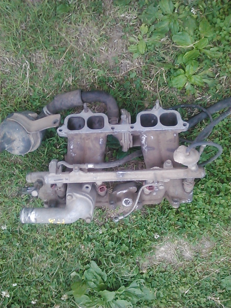

Here is a full shot of the fuel rail and intake. The only real place it could leak at in this area is the line or the orings that go on the injectors. Toyota says to lube them with gasoline. That will work and I have used WD-40 or anything. You dont want to stick the injectors into the rail dry as it is possible to knick the oring and leak there. I have been there and done that.

It's the thing that looks like a vacuum line but fuel is coming out of it
Old Jun 19, 2014 | 06:54 PM
Terrys87's Avatar
Posts: 11,787
Likes: 28
From: Anderson Missouri
The one line I see that isnt hooked up I believe circles around behind the thermostat to another line and should not be fuel but a water line. I can look tomorrow and double check.

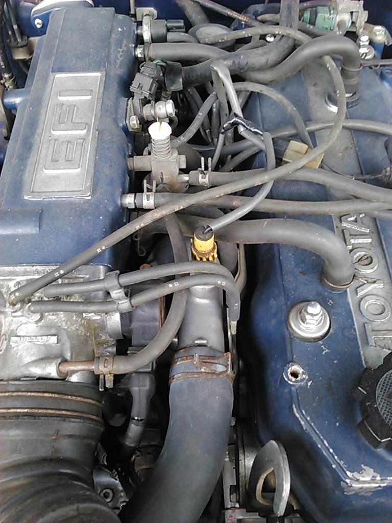

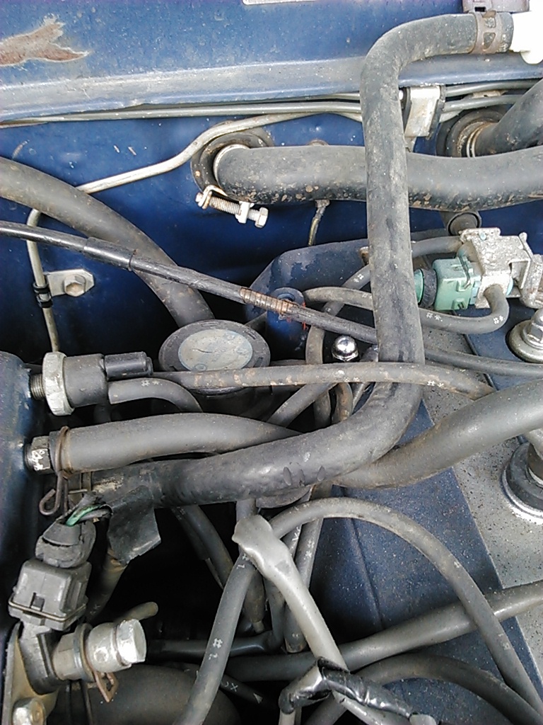

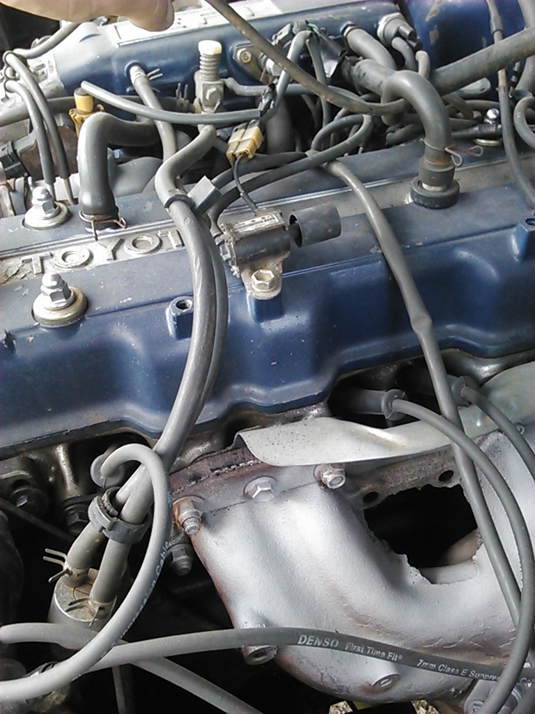

Could you send a pic also of your 22re so I can make sure all of my vacuum hoses are correct? Hopefully it's not sending fuel somewhere where it's not supposed to be. Thanks a lot!!
Old Jun 22, 2014 | 11:04 AM
Terrys87's Avatar
Posts: 11,787
Likes: 28
