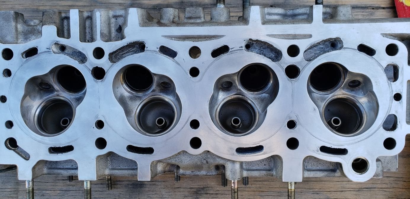

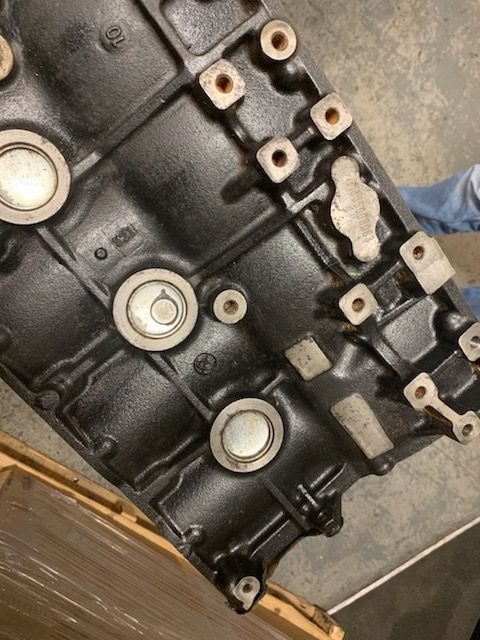

I am hoping someone can shed some light on this, we bought what was advertised as a brand new motor with all new brand new parts, a complete motor. The block did not have an engine number on it, and already after putting in this "brand new motor" the head gasket has blown. The cylinder head is warped and there is corrosion. Odin mentions something about electrolysis and ground wires, etc. The ground wires are in working order. My question is the motor had only been driven 4000K miles and other mechanics that we have shown this to have said that this would not have happened on a brand new motor. Is there anyone out there that may be able to offer an explanation? We had our original motor operating since 1992 and had blown heads, but never did it warp. A mechanic friend of ours says the cylinders look like someone bore them, and they are not new, shiny and smooth like a new motor would be. We were assured that the motor was a crate motor.
Best advice right now is to contact who you bought the motor through. See if they make good at all. Did you get a warranty with the motor? Paperwork? Did you buy it from a shop? Private party, is so what was their relation to the motor?

Thanks for replying. We reach out out to the company and we got the run around. The tech sent me a link to this site to watch a video on corrosion and electrolysis that a guy on here says can make a cylinder head corrode the way ours did. Our mechanic says no way, not on a new head would it corrode like it did so fast. We have a 3 yr warranty on parts, but they are saying a blown head gasket is not covered. The motor was purchased online and advertised as brand new. Not much in the way of paperwork. There aren’t numbers on the block either. We followed the new break in motor rules they supplied but now the truck is dead and we are trying to get resolution and answers.

That head looks like it is definitely a used one where in it's previous life did not get coolant changes often.
I bet that the engine was "rebuilt", at least to some degree, and is not brand new.

Thanks for replying. We reach out out to the company APR Auto and we got the run around. The tech sent me a link to this site to watch a video on corrosion and electrolysis that a guy on here says can make a cylinder head corrode the way ours did. Our mechanic says no way, not on a new head would it corrode like it did so fast. We have a 3 yr warranty on parts, but they are saying a blown head gasket is not covered. The motor was purchased online and advertised as brand new. Not much in the way of paperwork. There aren’t numbers on the block either. We followed the new break in motor rules they supplied but now the truck is dead and we are trying to get resolution and answers.
Get you shop and another to give their opinion on the age of the motor, corrosion levels/time to get there, before contacting the AG. AG involvement usually brings a ˟˟˟˟˟ show and the shop knows it. So if they can avoid it they will.

We have been building and installing 22R and 22RE engines since 1982. We have experienced many scenarios in the years since opening, including seeing vehicles without grounding straps attached that have developed electrolysis issues. The multi-layer steel gaskets exacerbate the situation far more than the factory graphite material gasket. Keeping all assumptions aside, we only sell new 22R and 22RE cylinder heads. Even our re-manufactured engines only come with brand new cylinder heads installed. You can check out or website for more information. I would attach a link but don't want to violate forum rules.
