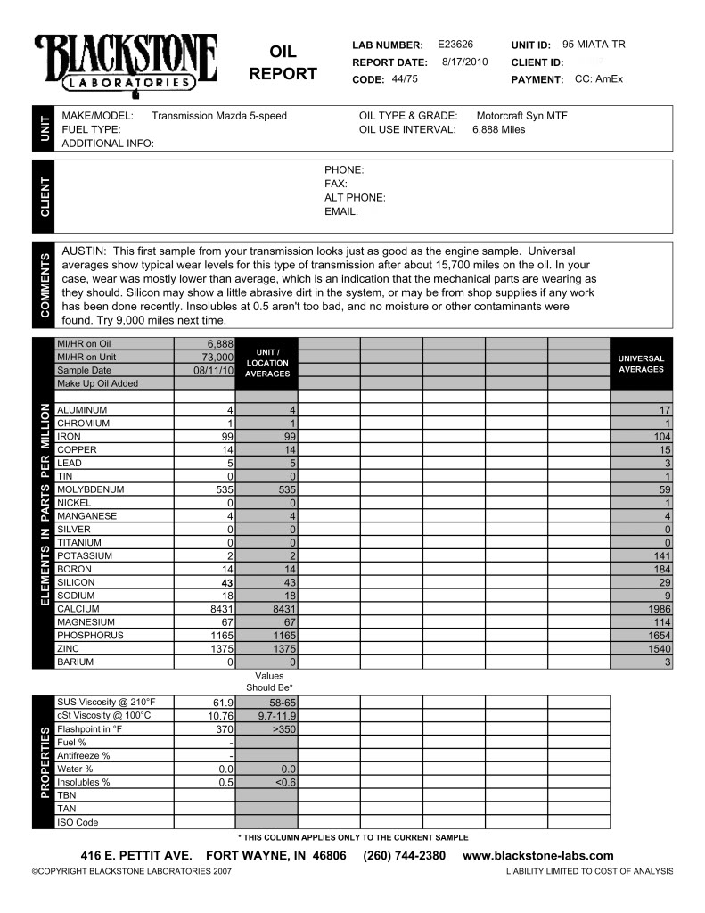

Originally Posted by zspokess
I'm about to install my new Marlin HD W56 transmission in my '86 4Runner and I see on their website that they "Strongly recommend" a GL-5 for the first 5-10,000 miles. http://www.marlincrawler.com/tech/gu...allation-notes
look at the context of the advice, the emphasis is on running dino fluid for the break-in period, not synthetics.
i'd guess that all of the gl-5's on the market today will not hurt the yellow metals in our transmissions, assuming that we even have any... wrt the cheap warren unilube coastal stuff that i'm running for break-in:
http://www.tractorbynet.com/forums/c...ar-oil-gl.html
the redline lube will be a definite improvement over that coastal gear oil... here is a lab report on the motorcraft fluid that i'm going to run, in terms of wear, it doesn't get much better than this:
"My OSA...
2 Full track days and probably about 30 autocrosses over the course of a year. I spent a lot of time on the rev limiter, so that combined with the track miles is why I changed it out 'early'. Looks ok?"

Thanks for posting a blackstone report. I do them pretty regularly with the motor oil in my E36, but haven't done the transmission or diff yet.
