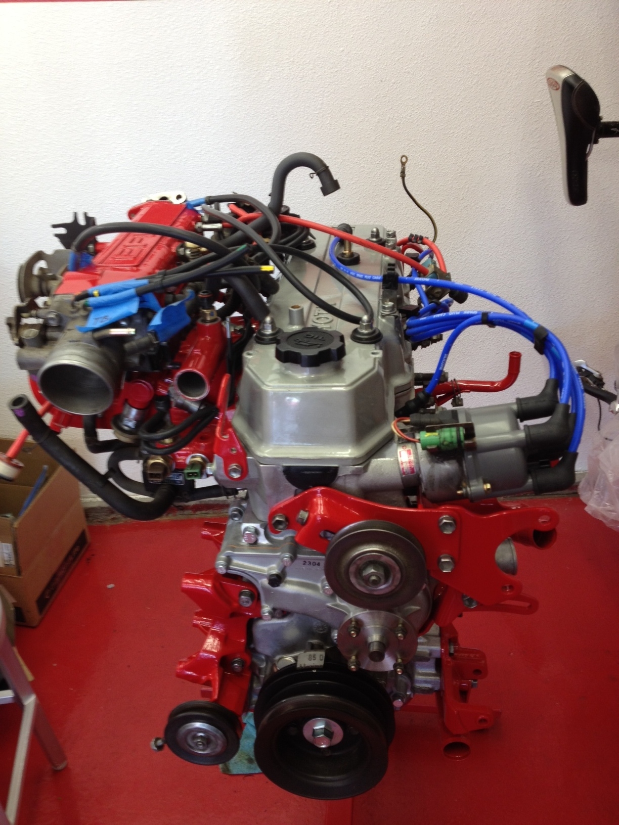

Hi, I know this thread is a bit old, but I have a similar or further question. I'm about to install my new Marlin HD W56 transmission in my '86 4Runner and I see on their website that they "Strongly recommend" a GL-5 for the first 5-10,000 miles. http://www.marlincrawler.com/tech/gu...allation-notes
However everything I read says that GL-5 in these is bad for the synchro's (Brass?). I called Marlin today and the sales guys answer to my question didn't give me a warm fuzzy fealing. "Run whatever makes you feel good"....really? thanks a lot.
So anybody in the know able to chime in with reasons why they might recommend this? I had MT90 in the old transmission and plan on switching back to it after the 10,000 mile break in of "no synthetic". Do they want to break down the new synchros bit on purpose to help shorten the break in period?
This is a long term rebuild (about 4 years) and a "forever truck" so I want to do whatever is going to get me the best performance and longevity out of this expensive transmission.
I know posts are always more fun to read with pictures so here are a few before and after shots, as well as the main reason why this is has been a (4 year project. I started it shortly after he was born, this is him helping at 2 and now he's almost 4.
Attached Thumbnails Manual transmission fluid advice-old22re.jpg   Manual transmission fluid advice-old22rehelper.jpg   Manual transmission fluid advice-new22re.jpg
