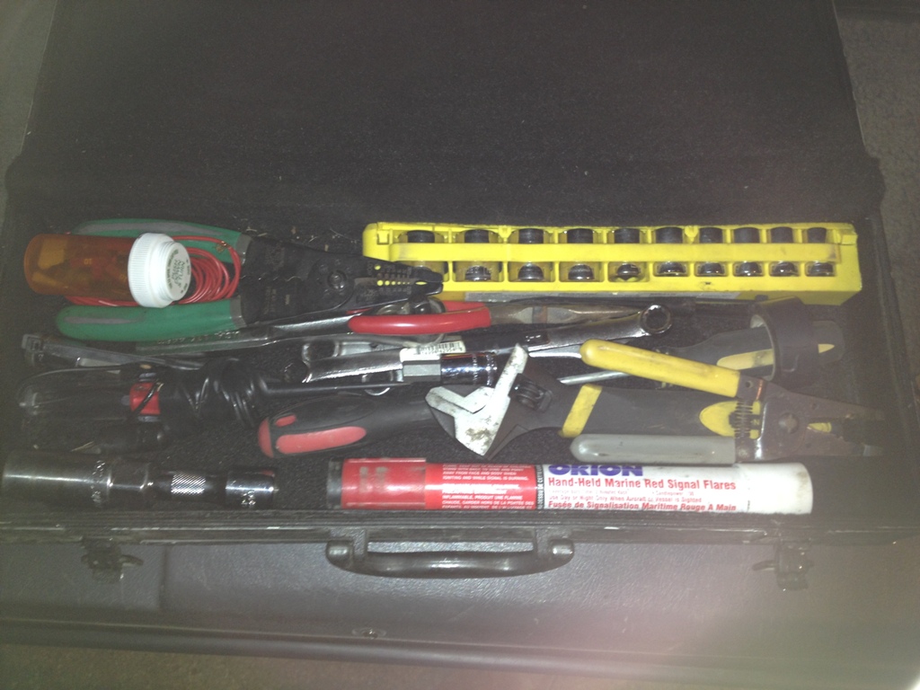

Interesting topic. I've got every tool I'll ever need in my shop but the great thing about a Toyota is that you only need a few tools to do 90% of the work. Here are a couple pics of my tool kit I carry with me in my 89 or my 02 4Runner. I can change the oil in any component, change plugs, wheels, disassemble almost any part of the body, and repair broken wires and switches.
Inside are some metric end wrenches size 8mm-14mm. Small set of Stanley metric sockets and a 3/8 ratchet, screwdrivers, crescent wrench, spark plug socket and extension, 10mm hex socket for differentials, wire pliers along with some wire and terminals, a rocker switch and a road flare. Probably some other stuff but you get the idea. My favorite thing about these trucks is how little you need to maintain them. A 1/2" torque wrench is something everybody needs at the house though. Invest in one of those and follow the torque specs in the manual or you'll also need to invest in a good drill and some metric taps.
Oh and by the way. Looking at that tool kit up there made me think of a joke I heard this week.
What do you call a guy who robs a Harbor Freight?
Pittsburgh Stealer...
Attached Thumbnails Maintenance Tool Kit for a Beginner-tool-kit-1.jpg   Maintenance Tool Kit for a Beginner-tool-kit-2.jpg
