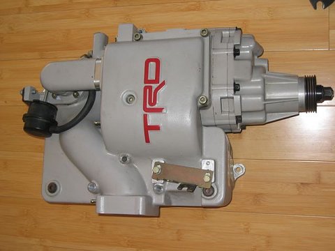

I have a 96 4runner Ltd. 3.7L v6 with a unidentified supercharger. This think is making all kinds of racket ! At low idol it sounds like a diesel motor. Its getting to at a point when im at a stop light i have to put it in neutral to shut it up! I just need to know if is it the bearings or is the S/C needed to be replaced? I have seen a nose cone bearing replacement kit, but I don't know what S/C model is, this is the best pick I can find that look just like my S/C
thanks ..... K13

that is a first gen gray SC sold through toyota dealers
the 2nd gen is black, and they are magnuson
there is a SC rebuild thread on yotatech, i'll search for it.
URD(underdog racing development)has lots of info/parts for them.

type TRD supercharger rebuild in the search box
https://www.yotatech.com/forums/f2/t...ebuild-264600/
heres one but there are more on the yt site.
you found the place for info on all things toyota
