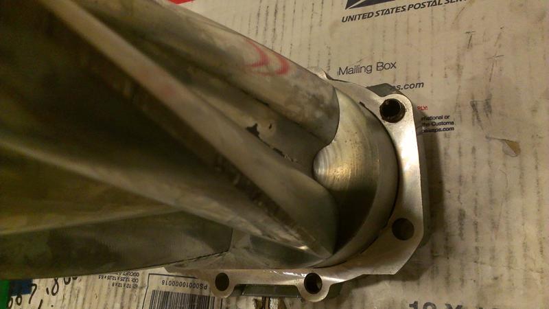

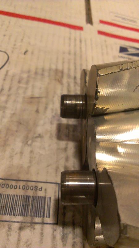

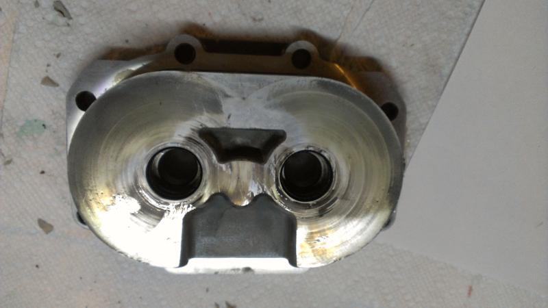

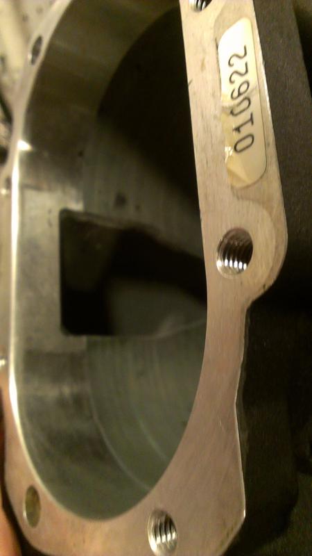

The second they got the sc they called me to let me know. Not a day later I received a phone call from the shop manager to inform me that he noticed the snout was heavy to turn and lacked proper clearance between the pulley and the snout housing. His explanation was that several places (magnuson) included, do not press the pulley shaft far enough into the bearing for the snout. This in turn pushed against the rotor assembly and that into the housing at the rear. Well that was money well spent right?

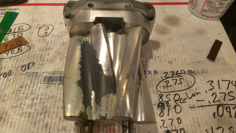

The third call I received was not good news. His thoughts were right on the money about the snout. He also found the coating on the rotors was coming off. And the worst part, one of the rotors was ruined by a dried bearing in the rear of the housing.

Now the pics

Well good to know there is another rebuild option out there although the coating service was not needed at all.
Eaton says that the coating does not effect the superchargers performance and that there is no reason to ever have it recoated. It is there for noise/vibration dampening. When injecting water/meth like you IIRC though that does a much better job.

I heard two sides to the argument, one from eaton and the other from places saying they dyno tested the theory and said they were able to pick up an extra pound or so of boost. Putting my setup against other similar rigs, I was making the same boost with the 2.1 pulley as they were with the 2.2 pulley.
