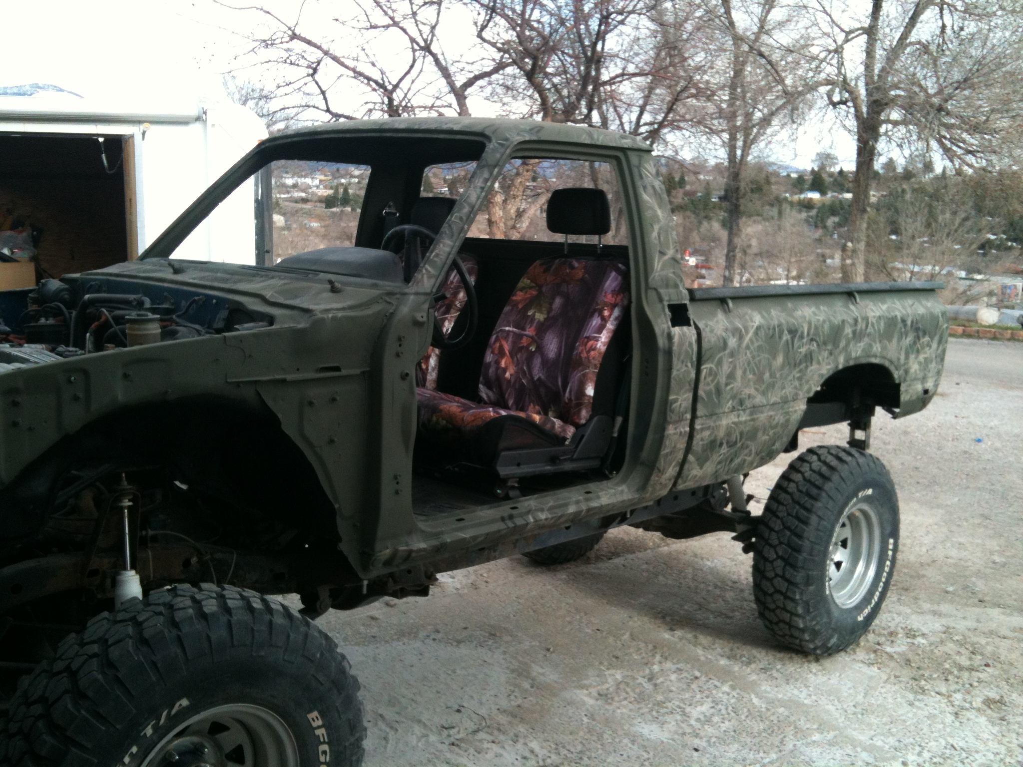

New to the forums here, but not new to Toyota's. This truck has been in the family since it was pruchased new in 1980. I recently bobbed the bed 15", cleaned up all the rust and am almost finished with the paint. New paint in bedliner in bed and cab also. This truck has a 3" body lift and a 4" suspension lift. The issue I am having is that it does not flex nearly enough for what I want to do. What do you all think my best options are? It still has the rear overload spring which will be removed today. I was looking at maybe longer shackles in the rear? Would I be be better off starting over with something completely new?
I will be ordering some bead lock wheels and some 35"s in the near future. Currenly it is running the 33"s that were on it before the body lift. The only other factor I can think of is that this truck is way over powered running a 5.0L from a 93 Mustang.
Looking forward to your input and being part of these forums.

63" chevy's for the back or deaver springs http://www.nwtoys.com/content/135-ch...-swap-faq.html
up front you can do the RUF (rear up front mod) or a set of lift springs.
http://www.trailslesstraveled.com/viewarticle.php?id=37
BTW thats gonna be a real nice 1st gen...

That is a good article on the 63" Chevy Springs. I think I am leaning towards that idea.

Take some weight off of the rear suspension (or remove 1 leaf pack) and measure the eye to eye distance. It looks like your shackle angle is near vertical. If so I bet that 57" fords would be just a hair longer and keep the same lift that you have currently (just as easy as chevys) I did this on my 85 and had to move my rear hangers back a bit to get a good shackle angle. Or you can move the rear hanger forward a bit and go with longer shackles - should help a bit with the rear flex.
As for the front - RUF (again what I did on my 85) Rim to fender I gained 5 1/2" in the front and 6 1/4" in the rear over stock (rim to fender no body lift) mine is able to clear 36" tires.
What are you sitting at rim to fender minus the body lift?
Hope this helps!

do chevys and ruf cheap and you cant go wrong..... oh and ditch the 3in body lift

Normally I would agree. I do not care for the way a body lift looks. The only reason I have it on the truck is to solve one issue. Without it, my engine is forced to sit to low and when you bind the front end up the axle smashes the oil pan, soon as it gets hit a couple time it will either crack or break the pickup for the pump.
