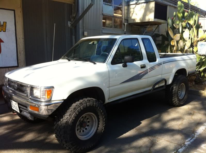

Thanks highonpottery. The lift I am getting will be 7 inches total consisting of 4" suspension lift, and 3" body lift so I am believing that 35x13.5 Toyos should fit nice and comfortable with that amount of total height hopefully
dang, i'd guess you could even fit 37s on that much lift i'd personally try the bracket lift without the BL first if you're set on a bracket lift. see how you like it and then see how much BL you need without excess.
in regards to your question about size of tires - not all manufacturers are equal and not all of them are actually the size they say, but will usually be within 0.5" up or down, usually down though. also, sidewall styling will make them visually look larger or smaller.
like i said before, i think 35s can fit on the amt of lift i have with some clearance work on the pinch weld/firewall area and the front bumper - those are the two spots my tires used to hit on ~2" of lift. it's all personal preference though - i believe in keeping it low and would rather clearance for a tire than lift and add unnecessary wind resistance, higher COG, less stability, etc. personally, i think a 34" tire would be best on my setup and gearing, but options are limited just like they are for a 33x10.5 tire.
here's my rig on 33x12.5s with 8" wheels:

I really like the look of 37 inch tires on the 3rd gen trucks indeed, and I originally wanted to run that tire size, but I keep reading that anything over 35 inch tires would be too much stress for the IFS on our trucks and that I would need to buy heavy-duty axles and cv joints and even then I hear that problems could arise with any tires larger than 35s. I dont plan to wheel it really hard to be honest as this truck is intended to get me to work in the winter time in snow where my Mustang GT cannot go. I also would like to do some mudding and trail riding, but nothing that hard on the truck as my father was the original owner of this truck which he purchased brand new in 1990 and I just bought it from him. For that reason I dont want to go with a SAS and change too many things on it and so I just want to do the minimum to get larger tires on it for deep snow at the least. I will admit that I love the way 37s look on these trucks for sure but I dont want to change too many things as I really wont be getting too hard on the truck and just like the look of a truck with a nice lift and large tires.

i forgot to say thanks for your pic that you posted here. I really appreciate it.
