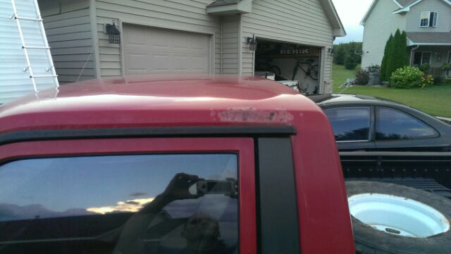

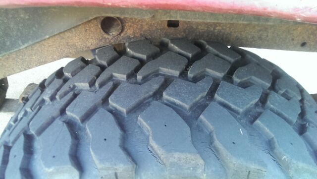

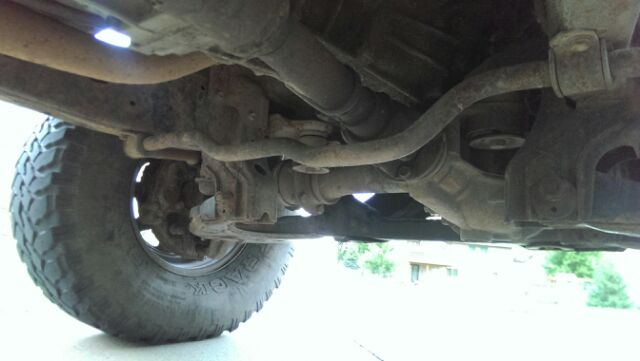

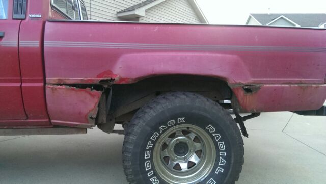

Here's some pictures.
Attached Thumbnails I need tips and advices please!-image-1814090967.jpg   I need tips and advices please!-image-1988399433.jpg   I need tips and advices please!-image-1384142799.jpg   I need tips and advices please!-image-2375249706.jpg   I need tips and advices please!-image-3858236058.jpg

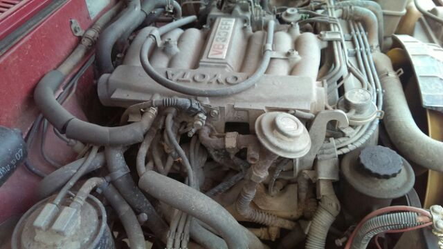

First of all, that engine is NOT a 22re!! Its the 6 cylinder 3z so right off the bat if the guy is telling you its a 22re he doesn't know what the hell he's talking about. It didn't look at the CL post, only your photos. But regardless, the engine could be in good shape...or not. Do a compression test on it. Invest $50 in the tool and it will take you maybe an hour if you've never done it. If the cylinders are in spec and the front end seems solid, go for it.

Its the 6 cylinder 3vz. The 22re is the 4 cylinder engine. I doubt its been swapped judging by the pics, but not 100%. Seems like the dude would tell you if its been swapped and the that would change the "original mileage" of the truck. I mean I'm not saying the 6cyl is bad, just not the 22re. If you're hauling a boat, the 6 is prob better. If you are new to buying cars, get a buddy or mechanic to look at it quickly, pull the spark plugs and see what they look like or indicate. There is plenty of info on the web and on yotatech on this subject. Ask when the last maintenance was done. When I bought my truck with the 22re, within 7 months it needed a new fuel pump which cost nearly as much as the truck since I hadn't got the confidence to do my own work yet. And if you're buying this, go ahead and buy yourself some tools to boot.

Calm down ace. The craigslist ad says it's the 3.0 V6. The first mention of a 22re that I see comes from highonpottery's comment.
