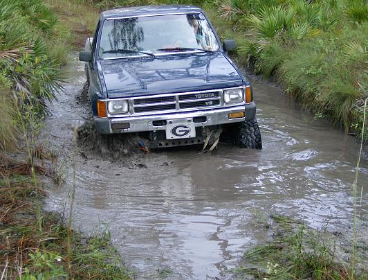

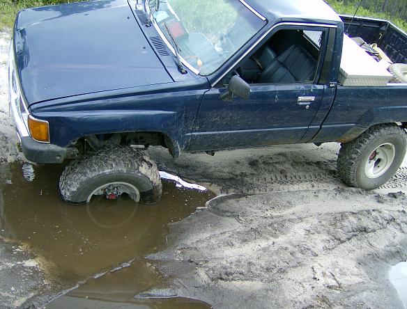

Hey guys i went in the woods today and played in the mud. well lets start of my clutch boot on the side of my transmisson- if water gets in it it can make my truck seem slugish right? second is there a vent on top of the transmission cause i put my truck in 4wd because i got stuck in a hole and it was smelling weird from the vent looking thingy. third i noticed from one of my pic when i was in 4wdH my truck didnt act like it was in 4wdH and the pic my driver side tire wasnt spinning like my passanger one. next my cv joint on my driverside has a boot on it and it is dry rotted and is leaking grease can yall help me figure out what to do? Any advice

the pic on left is hole i was stuck in first and my 4wd and the vent thing was smoking. the next is my tire not spinning. i think im just goin to buy new cv joints on bothe sides. what yall think

If water/gunk gets into the trans then you could have some major problems down the road.. Can rust up your clutch componants and coat the flywheel so the clutch just slips...
Seal that boot back up!
IIRC the trans is vented through the shifter plate...
Its normal for just one front tire to get power, you have an open differential, power will go to the wheel of least resistance (same in the rear unless you have a LSD or locker).
Replace the CV axle thats dry

The reason only one tire is spinning is because you have an open differential. It's supposed to do that but if you want more traction buy a locker or weld the spider gearsand they will turn at the same rate.
If water gets in the boot over the clutch fork it will get crap in your bell housing with your clutch and make it slip and eventually you will burn it up. Not good. Get some "Right Stuff" gasket maker and seal that boot in there so no water gets in
The smell you smelt was probably your clutch burning up from water in the bell housing.
If your cv boots are torn and rotting replace them
Your gonna get stuck a lot with open diffs, start off with a rear locker you will be amazed how much more stuff you will get through
