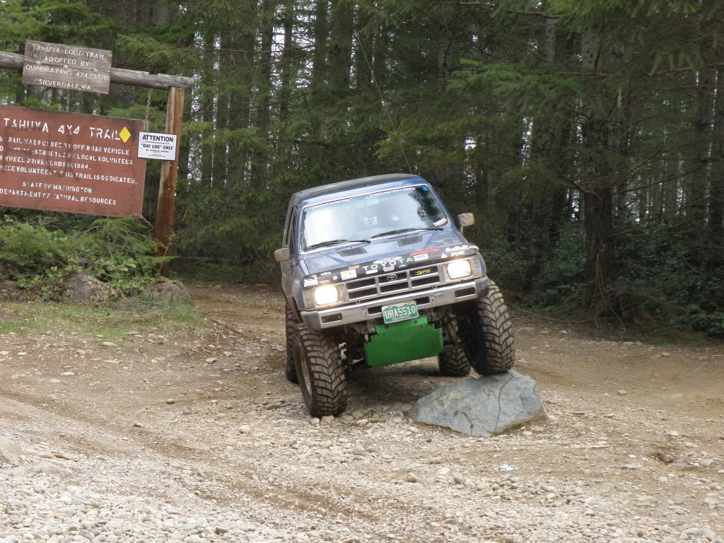

Hmmmmm, sounds like a decent mud terrain with siping will work for you. Remember, airing your tires down makes a big difference!!!
