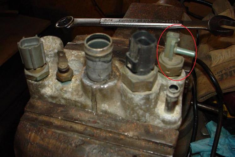

Hey guys I just picked this truck up for a steal. I have found a hose disconnected from a fitting. The fitting is broken off. Please refer to the picture to better understand.
What is the part number for the circled part, and maybe more convenient for me, where can I buy it?

I believe it can only be had at Toyota. The part numbe should be on that part, in very small print.
They are cheap enough that you can just get one at Toyota and save yourself the time and hassle of getting a used one.
