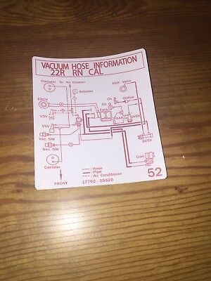

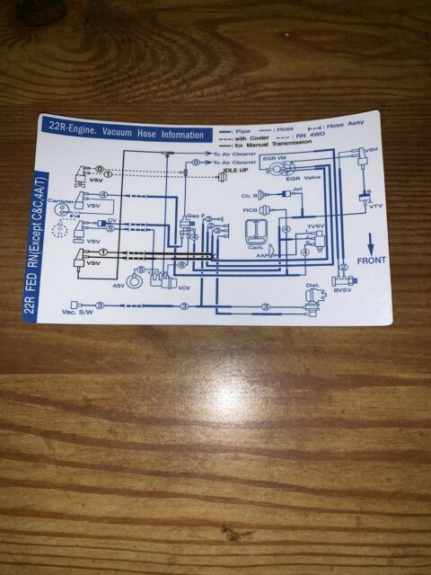

Which reminds ME, did you look for the vacuum diagram sticker on the inside of your hood, like I mentioned? If you do have one, can you maybe take a picture of it and put it up here for us? It would be a huge help.
Now, let's see what we can dig up for vacuum diagrams for you.
There's 3 diagrams, all slightly different. Can you look around your engine carefully, and see if some of the vacuum lines shown in the diagrams match those your engine has? If you find one that matches mostly, that's probably the one you need. You just need to look and see where the lines you don't know go, if you understand.
