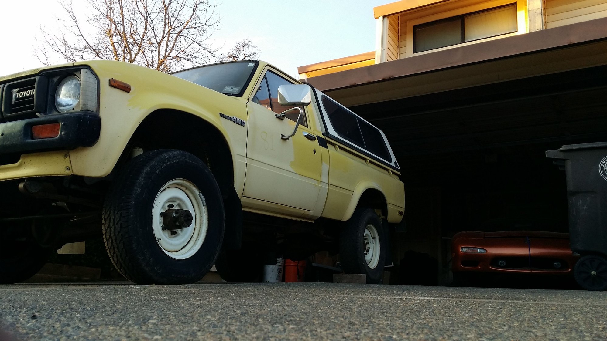

I just got a 1981 4X4 truck and would like to lift it.
It is currently all original and I would like to give it 3"-4" more suspension height.
I would like like more suspension travel and good shocks to retain road worthiness and be able to do some mild crawling.
I am a first timer with lifts and Toyota trucks so please bear with me and lend a hand.
