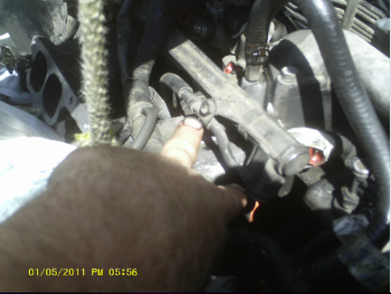

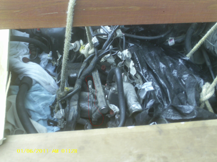

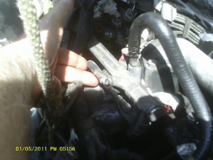

Old Jun 6, 2012 | 04:23 PM
randes's Avatar
Joined: Jun 2012
Posts: 50
92 toyota truck 22R-E
Yes that looks like the part.
I would like it to stay there tho. I want to take the hose off thats on there, it isn't coming off. I'm not sure its suppose to, I don't want to force it. If I can't get the small hose off it looks like I can take off the two bolts holding it on?
What I want to do is lift up the head up and get to the gasket. I hope I can get it high enough.
I wasn't able to get the wire off that go thru the intake manifold to take the whole thing off.
Any of that sound reasonable?
Here are some better pictures circle in the right places.
Attached Thumbnails Head gasket-1.png   Head gasket-02.png   Head gasket-003.png
Old Jun 6, 2012 | 04:46 PM
85TurboRunner's Avatar
Joined: Aug 2004
Posts: 2,077
From: Vancouver, WA
That hose has a banjo fitting that goes to the fuel dampener. Seriously its 2 bolts and then the dampener. Don't remove the hose from the fittings.
You need to completely remove the head from the truck to clean the surfaces anyway. And once you pull the head you should take it to a machine shop to get it decked if it needs it.

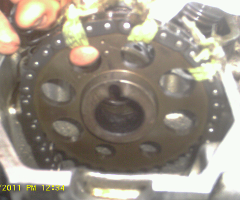

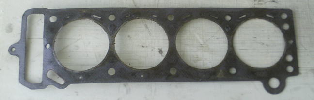

Here's a photo of the chain. It looks good to me. No scratches that I can see, definitely not beat up. I know taking the whole cover off would be best but look down inside I don't see that its beat up or gouged. The chain was on real tight when I took it off I knew it would be hard to get back on, it really popped off and dropped down with force if that makes any sense. Back to that question, how do I get the sprocket back on the camshaft with that chain so tight? Would a real long wrench, that I don't have, get down to the tension bolt to loosen it a bit? I thought about loosening the eight bolts on the shaft getting it on the sprocket and see if I can force that down. Its so close, it wouldn't take much to get there.
What are some other ways they can mix?
I just added some pictures of the head and gasket.
The had some fluid in it and one with some on the top.
thanks for the help so far.
