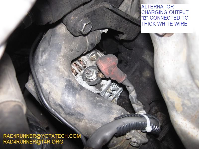

After you replace your battery. If it's still happening, check if your alternator has a bad rectifier (draining battery to ground).
Disconnect thick "B" wire from alternator screw terminal, and measure resistance to ground. You should get meg-ohms or greater, not kilo-ohms or less, if alt is good.
