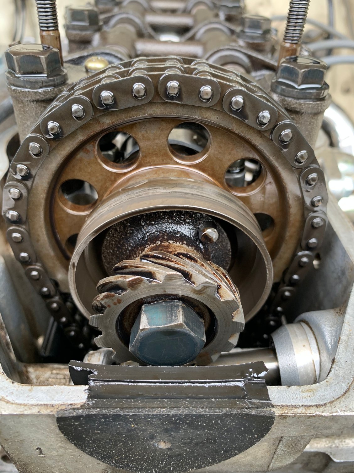

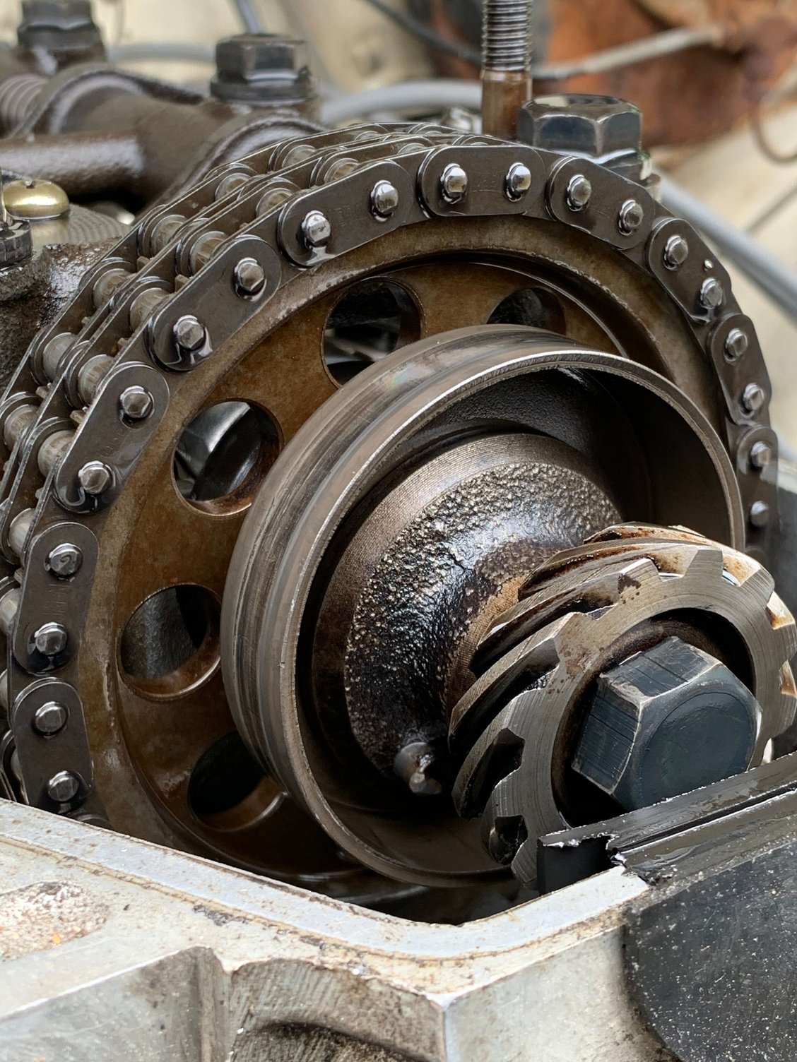

The camshaft spins once for every two rotations of the crankshaft. This is a basic principle of every four stroke engine.
If you have the valve cover off, the easiest way to confirm TDC compression for cylinder #1 is to look at the cam sprocket. Look at the dowel pin on the distributor drive gear at the center of the cam sprocket. The dowel should be at the 12:00 position.
Alternatively, there is a small dot molded into the sprocket near the outer edge by the teeth. This dot and a similar dot on the lower cam sprocket are only used during assembly to align with two brightly colored links on the chain. The links only line up once every few rotations so don't concern yourself over any links and dots aligning. When the engine is at TDC compression stroke for cylinder #1, the dot should be at about the 11:45 position, basically just slightly off of pointing straight up.

When the engine is at TDC compression stroke for any cylinder, the cam lobes for that cylinder should be equally far away from their respective rockers. In the case of the 22R series engines, the lobes should be pointing pretty much down (one down to the left, the other down and at and equal and opposite angle to the right).

Thanks very much. Here is the cam sprocket with the dowel pin shown when the timing mark is at 0 in both positions.
While not exactly at 12 o’clock I think the second one would be the correct one? Putting my finger over the spark plug hole there is outward pressure while cranking to that position.

This is backwards, when the valve spring compresses the valve opens, all pressure off of the spring when the rocker is loose is when the valve is closed.
TDC compression stroke is when the valves are both closed and the timing mark is at zero (piston is at the very top of it's stroke).

Ahh thanks that makes sense now that I think about it. I think I got it to TDC and reset the distributor but I still can't get it to fire.
